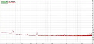

Did the noise test just for the craic.
That is a recording of the UCA 202 with no input. The RCAs are OC which accounts for the 50Hz blip I suppose (although I did have the laptop charging!) I don't really know what the blip at around 330 Hz is but the spectrum is pretty damn clean for a 16 bit 25 quid device IMHO!
I could post the MP3 and the .PNG of the spectrum but NOT the .png of the meter in Samplitude !! Suffice it to say it showed a peak noise level at -80dBFS and an rms noise at -88ish dBFS. Those are raw, unweighted figures and everyone uses weighted figures (but don't always tell you!) and thus a figure of around -95dBFS could, I think be justified? No noob is going to have a mic/pre/mixer/room close to that noise floor.
