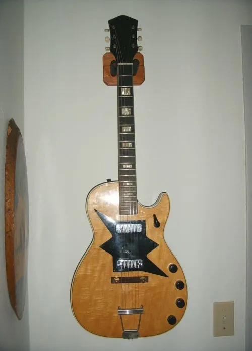

Just thought I'd give y'all an update on the old Harmony.
I finally took it to a local luthier to take care of the pearloid fretboard markers that were cupped. He did a little re-gluing and sanding and now at least the fretboard is flush. This cost me all of $27.50. :)
After I got it home I plugged it in and played for a while. This thing has wonderful tone and plays pretty well - good enough for just about any kind of rhythm duty, and maybe some lead work, too. All the controls are stiff and noisy, so I need to pull the pickguard and spray them down with contact cleaner. Also, a few of the frets on the low E side need reseating. No problem there.
What a nice surprise that the old dog sounds pretty and can play. I don't recall, as a 12-year-old, paying that much attention to its tone; I was just happy to have an electric guitar to play.
Do y'all think I should try to file the pearloid inlays flush, or pop them out and re-glue them?

Yes, they're celluloid, I think. They weren't cupped at all four corners - in fact only two of the inlays were really bad, and they were raised up on the high E side, enough that the strings would catch on them, but not fully out of the cutout in the fretboard
They look OK - a little scuffed on that edge from being sanded. I can see that the luthier addressed all of the inlays, though, to make sure that they're all flush.
