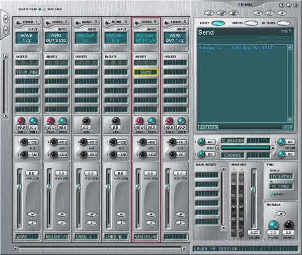

Can you post a screenshot of your patchmix program? That might help a lot. remember to save it as a jpg.

Usually, you need the Patchmix software to route inputs and outputs to the different ports on the EMU. I don't know if it's 64 bit compatible or not, you'll have to check EMU's website. Most likely, the spdif is not available without the Patchmix program running.
It looks like this:
