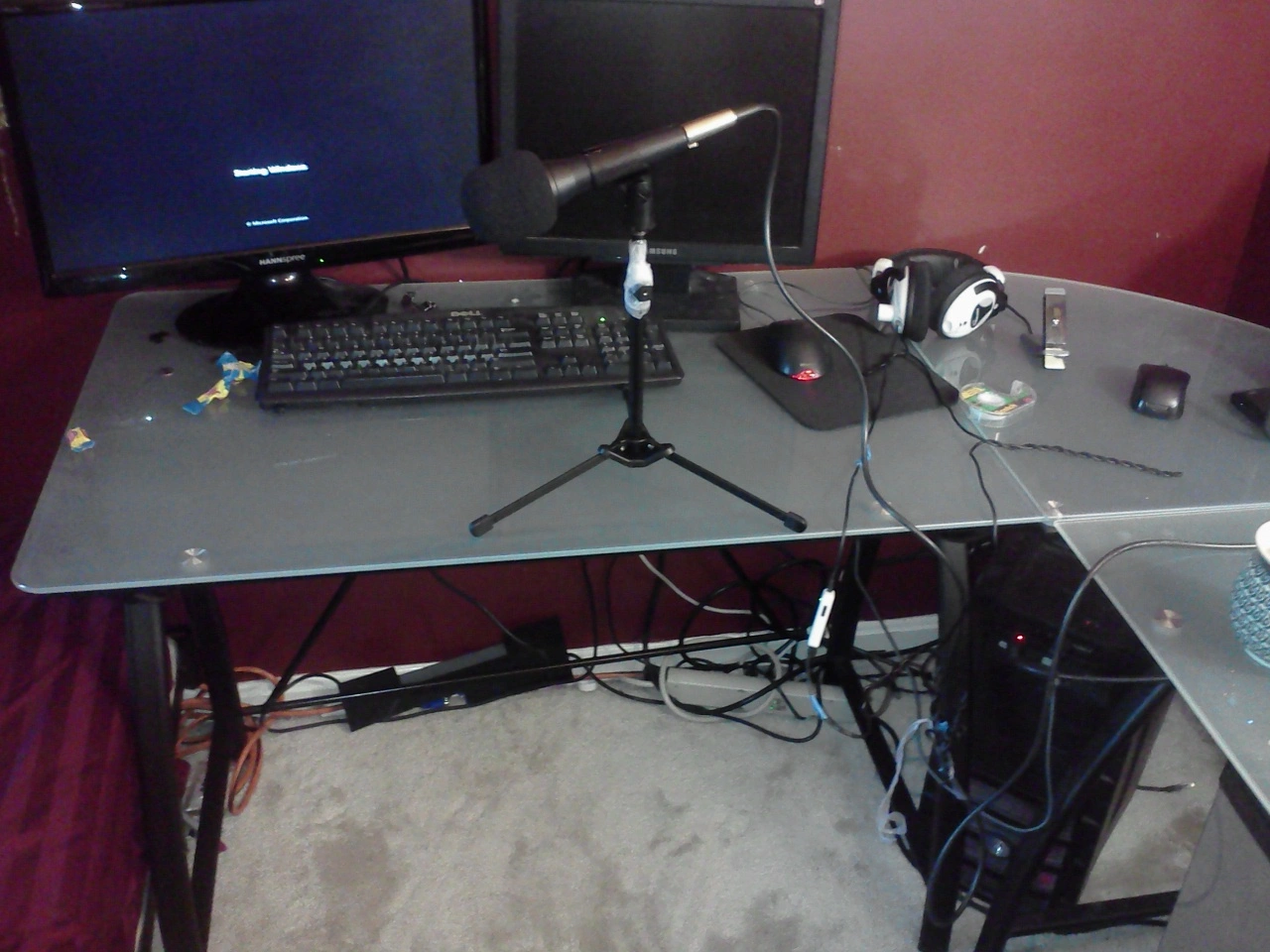

Heres the pic of my setup
With the mic aimed like that, the computer is partly within the pickup pattern. If you can lower the stand so the connector is pointing straight at the computer (and the mic straight at your mouth) it will help at least a bit.
I'd also be worried that the glass desk may be adding to the noise with physical vibrations. I'd consider a floor stand with boom arm to decouple the mic from the desk.
Beyond that, if you can get the computer twice as far away (either by moving the computer or your mic) that will quarter the amount of sound from it that gets to the mic.
Some sound absorbing material (soft stuff on the wall, carpet on the desk) would also be advantageous--nothing but hard, reflective surfaces in your pic.
