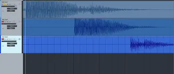

Some DAWS call them "regions" other "Events". What I am talking about is the cone shaped sound wave you see in your DAWS editing grid.
When editing drums you'll usually see a cone shaped sound wave for each hit that shows the initial hit (largest part of the wave) and then it tapers as the what ever drum sustain tails off right? Even on a quick roll of 4 or 8 hits you usually can see the peak of each hit.
My problem is I have a couple songs I have to edit drums and the people that recorded the drums must have done something wrong with their set up as the quick rolls are all mush meaning there is zero distinction between each hit and makes it impossible to see where each hit is. Its all just one big long tall audio region that does not show ANY variation between hits. I can guess where the hit are, but they are soo fast that I feel I would screw the song up if I guessed wrong.
My question is.... is this a performance technique my the drummer ? Is it a gating setting set up wrong, are the Preamp trims set too high ? Is the drum heads too boomy that they sustain too long. I have never encountered this before and is very frustrating.
I am trying to figure out how to coach them so the next tracks are not so time consuming for me. Any ideas how should I tell them to change their set up ?
thanks for any tips. I hope I explained it ok.

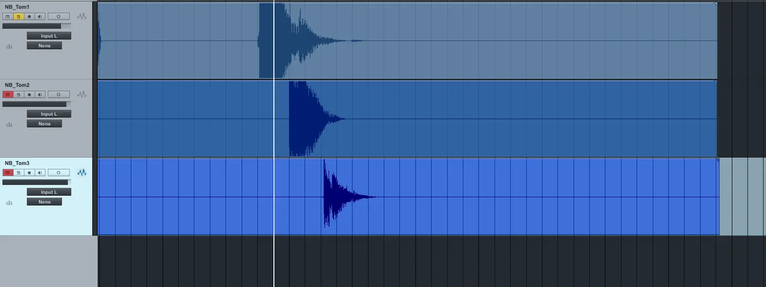

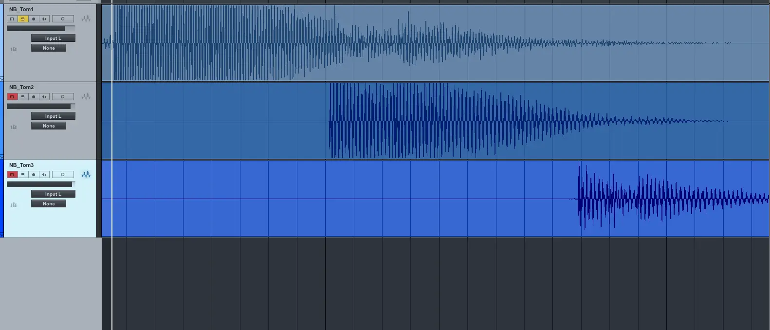

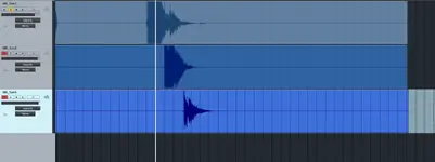

My samples
I hope this works. 4 attachments.
1 is an MP3 of a tom roll (look for the little blue underlined html link labeled Tom Sample). all the attachments are kinda squished together.
1 picture of the sound region of this mp3 zoomed in
1 picture of the sound region of this mp3 zoomed out.
As you can see NO definition in the sound wav. Other drums I have done with similar hits have a definition on the initial attack so the trigger program will recognize when to trigger and what to filter out.
The "Good" picture is what I would consider a good looking and normal wav form and what I am used to seeing even with faster stick work by the drummer.
Thank you for checking it out.

I dunno....in the bottom two pics it looks like the recording was done too hot, and hits look clipped off at the top...
...or, you have the wave view zoomed in too much, and the wave only "appears" clipped.
Which is it?
The sound bite doesn't sound like the audio was clipped.
Which is it?

There are two pics one zoomed in the other zoomed out. No matter how far out I zoom its still just a solid mass LOL, it just gets smaller. No peaks to be found anywhere.
If you zoom out and the tops of the waveforms are still flat then the recording was clipped on the way in.
If you're certain this is the case, advise your friends (or whoever recorded the drums) to do a proper soundcheck and set their preamp gain levels so that the peaks are well below zero at the converters. Say -10 or so?
Tell them to soundcheck loud. <sigh> The number of people who soundcheck their 'peak' levels then bang the drums 10 times harder during recording....
Clipping is irreversible. Then peaks should still be identifiable though - Good enough for sample replacement software to know what's going on, I guess.
I'd say try this *this* time, and make sure your guys avoid clipping next time.
I don't know what DAW you are using...but most have two types of zoom.
1. Track zoom.
2. Wave zoom.
You're zooming in/out with Track zoom.
Check your Wave zoom for the tracks that have their tops lopped off.
When audio is THAT clipped off...it would be very obvious on playback. Your rolls sound fine (a bit too much room and resonance, but not clipped)....so that's what I think you have the Wave zoomed in on those tracks.
Maybe the audio was clipped...but it doesn't sound like it.
I've done it accidentally when working....it's a keystroke, and all of a sudden the wave looks like what you have.
