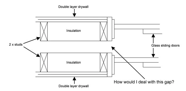

Okay, now that I've leased this 1875 sq. ft. building, I'm considering some double wall construction.
I'm considering using sliding, double-pane doors between some of the rooms.
My question is illustrated in the attached jpg. How would I aesthetically deal with the gap between the two walls at the doors? From what I understand, I won't want these walls to be coupled whatsoever. Correct?
Any ideas?

most likely you will want it filled with something durable and cushy, like neoprene.
