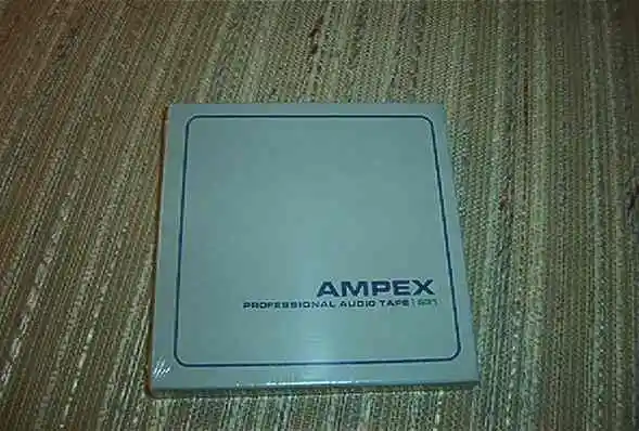

Oh boy I have 18 rolls of this 5 inch 631 still in the plastic.
I have tried it on my machines and its ok for just messing around.
I mostly use it om my teac 2340. No telling what it is biased for.
I read somewhere 631 I think used to be used alot in some pro studios and that it will just about last forever. Time will tell ;)

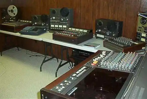

Ok just had to add some pics of my new display tables for some of my stuff.
I know Reel is just drooling cause he wishes he had this much stuff ;)
