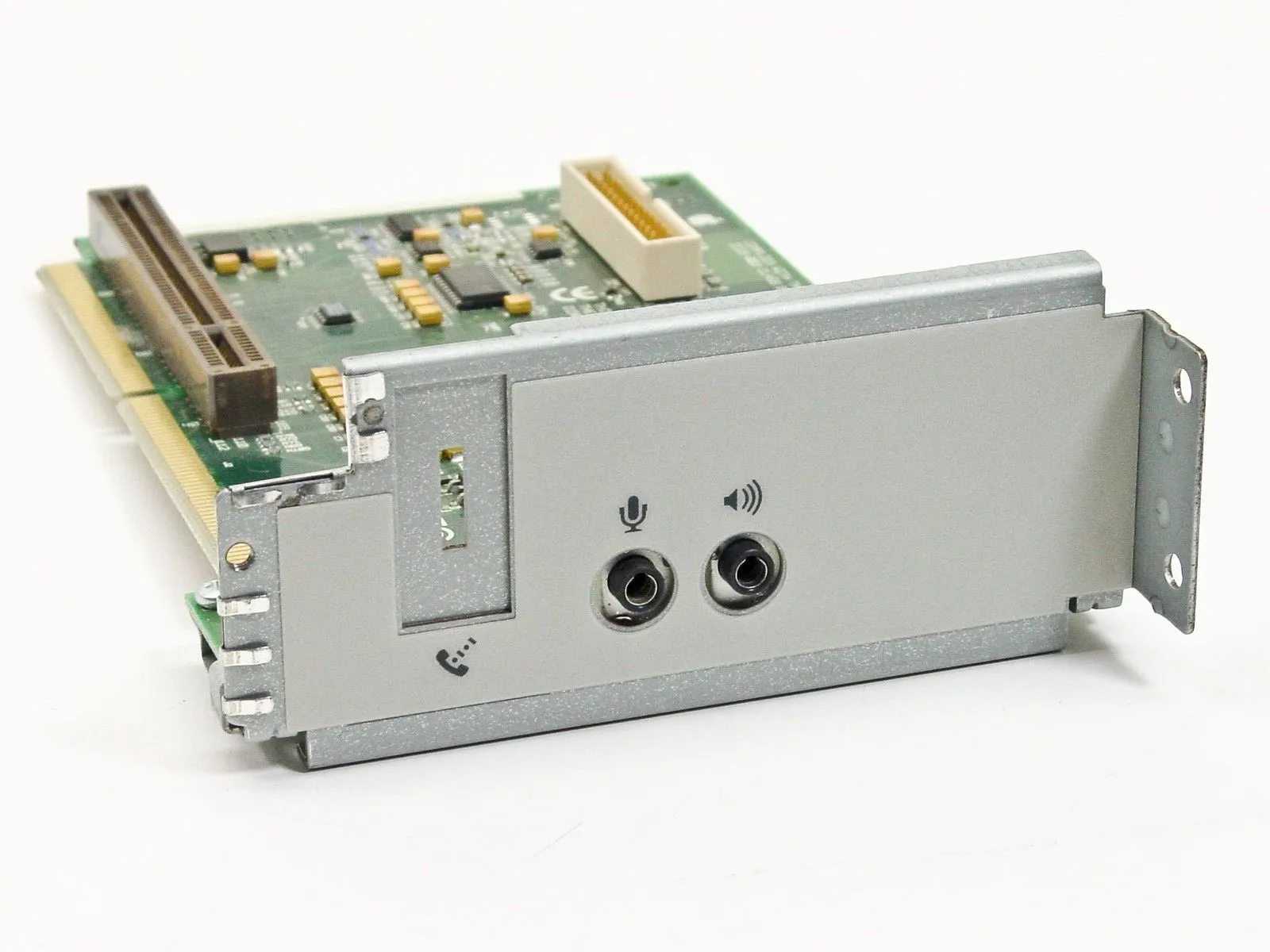

Here is a picture of a soundcard as the one in this computer $_57.webp You may see the inputs

That said,.I'm pretty sure your sound card just has an in(mic logo) and out(speaker logo),.but you should be able to select either line or mic in the software/driver settings,. look to make sure its set at 16bit/44k while you there,. should be in the same place.
I'll take your word that the mic input is stereo (but I have doubts that it actually is) Line-in inputs on computers are usually stereo, and mic inputs are mono. TRS does not mean it is stereo.

I was testing the input in the Pro Tools FREE in the mac os 9 and it seems to work stereo. It recognises left and right on their own place. Also, I updated some gear that could help me get a better demo
