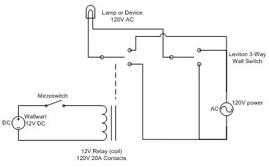

Sure, I had that in my home studio before I yanked it all apart - I used a 6"x3" aluminum panel and had 10 switches mounted on it.
What I did though, instead of wiring the electrical right to the switches, I ran it in the wall and used the smaller switches on the panel to switch relays, which were mounted in the electrical boxes with the regular switches, which were 3-way switches (and the relays were DPDT 120V relays with 15A contacts).
Easy enough to wire, I can help you with that if you like.
I liked using relays because I didn't have to have a giant knot of thick wire weaved through my console table. I was able to use cheasy, smaller wire.
In fact, using a 12V wall wart and 12V relays instead is a nice low-voltage option. Then at least if the wires behind the panel get touched, shorted, or the solder joints go no fire, damage, or injury.

I had 10 switches with a shared lead, so that required 11 conductor cable of about 20 gauge. This translates to alarm wire, which i got mail order, which gave me 12 conductors. I added the extra wire to the common, though I didn't need to.
Here is the schematic of the remote switch thingy I did.

Relays do make a click, but if you mount them in the electrical boxes I seriously doubt you'd hear them. Take a pencil and tap the eraser on your desk, thats about how loud my below recommendation will be once its in an electrical box.
I used these:
10-Amp Plug-in Relay-12VDC
$7.99 Brand: RadioShack
Catalog #: 275-218
I remember when these were 3.99 :D
12VDC coil, and 120V 10A contacts, more than enough for any lighting needs. Your event 20/20 BAS's draw less than 10A as a pair, so this is just dandy.
Solder the wires, don't use spades, this way there is no chance of anything coming loose and shorting in the electrical box.
Hope that helps!
