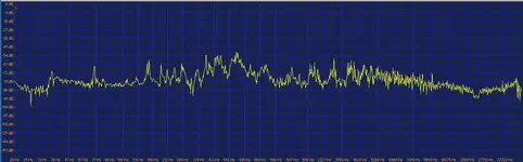

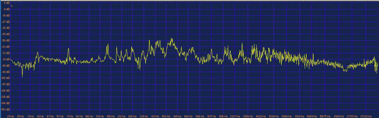

Here is a last bit for tonight, this is a single crash hit (Zildjian 16" K Dark Thin) recorded with a 6mm capsule omni mic (fully capable of ultrasound, but not calibrated above 20kHz) at 24/96--tough to analyze, so I selected 31 of its harmonics from 36Hz to 30kHz (as high as my tone generator goes) and did a half-ass version of additive synthesis--not too bad, a real synth would have to add a shaped noise signal, but that is what makes it tough to analyze. I'll post that .wav up to my FTP tomorrow if anybody wants to play with it.
