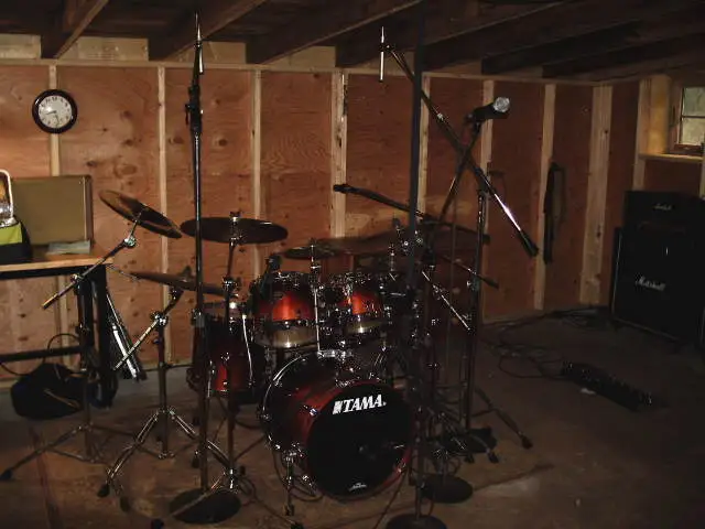

OK, 30dB of TL is *terrible*, so I suspect you have measured that incorrectly. That's a stock interior uninsulated 4" stud wall TL.
See the table here under "partition type", with 14" decoupled walls you have >60dB *if* you built it correctly:
Sound transmission class - Wikipedia, the free encyclopedia
Next, throwing extra panes at a problem is usually the wrong solution; two thick panes can be better than four thinner panes, but it also depends on the spacing of the panes. You would be better with two pairs of tightly spaced panes with a wider cavity between. If you have roughly equal spaced multiple panes, that's where you can create a resonant structure that makes TL worse at some frequency. From your photos they look equally spaced; that is suboptimal.
Carpet samples are not good for room treatment because they do not have a wide absorption bandwidth. You get a room that is dead at HF but still with significant peaks and nulls in the LF response. Also, it appears from the pictures you have oriented your mix position across the short rather than long axis of the room, which reduces the delay time of the reflection off the back wall to your mix position. That is suboptimal unless said wall has excellent absorption and diffusion characteristics . . which carpet doesn't. You control room looks very small; you'll need serious broadband absorption for a reasonable room response. I would recommend 4" thick rigid fiberglass panels across all corners, ceiling to floor and also ceiling to wall, with added panels spaced 4" off the wall to the left and right of your mix position and also on the back wall. If you find you need to brighten that a bit, you can use facing on some of the panels so you still get the LF absorption.
Insulation is a weak material for improving TL; you need to rely on a proper decoupling structure with *mass*, and lots of it, hanging on those studs to absorb the energy being transmitted by all of that moving air!

My measurement was made with my sound pressure meter set to A weighting. The microphone was aimed at the door. The door is 5" thick and filled with fiberglass insulation. The windows have worked perfectly just the way they are for almost 20 years. 30 db is exceptional, practical, soundproofing. A loud band playing at 100 db will allow myself to have a quiet conversation on the telephone in the control room. I built this studio when I was in my twenties, not bad converting an old cow barn into a money making studio. Your response just shows once again your arrogant, pompous, condascending and know-it-all personality.

Does it look like the exterior walls and ceiling are finished yet? Man, you are difficult!

You said your wall are 14" thick, so you tell me . . . what's on the other side?
Also you built it 20 years ago? When are you going to finish the walls?

It is a renovation, Squirrels had moved into the ceiling and walls. For such an expert on my studio you have not been paying attention to details. The control room walls are 14" thick, like your head!!!!!!!!

So those are exterior walls? Yeah, still some work to do then. You really need decoupled walls if you want good TL.
Do something about that carpet though, you'll be happier with fiberglass panels.

Well there is a stone foundation and earth behind them (with an air space yipee!), I thought you already new that being the expert on my studio. I am already happy with my decision for finish and treatment materials thank you very much!
