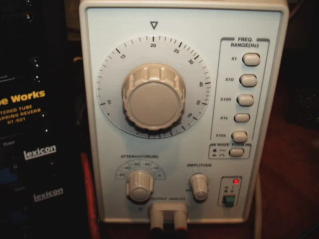

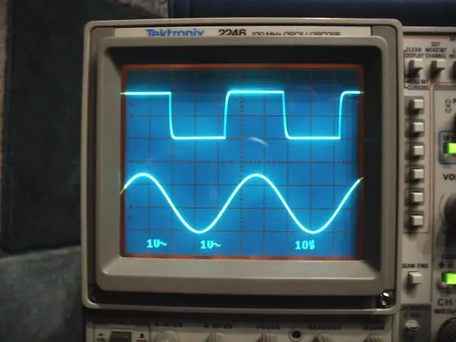

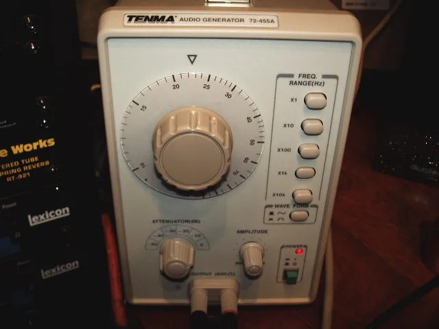

Well, it sure is funny that a 1K square wave in produced a 1K square wave out, but a 10K square wave in produced a perfect 10K sine wave out. The analog experiment looked quite different.

Well there is still something wrong with the pictures, they are not going in as I wanted them too. Here are the pictures of the analog test. Square wave in does not come out square, just as I expected.

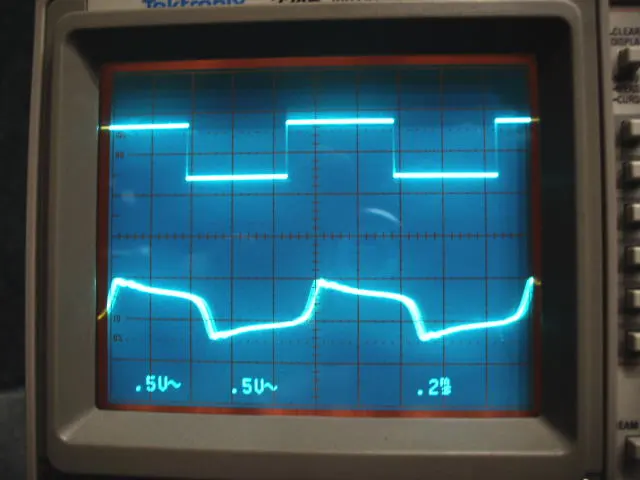

I am going to try to load a picture of the square wave Digital output at 1K. It remained a square except for the superimposed sample ripple.

That's 10k? It's pretty good isn't it? What kind of bandwidth then does it take to do that? Quite high presumably?
VP
It's not funny, it's the way it should look. Review my Excel chart again--with 10kHz, you have no harmonics at 44.1kHz so you get a 10kHz sine wave. At 1kHz you have 3, 5, 7, 9, 11, 13, 15, 17, and 19kHz, which will look like a square with overshoot and ringing.
I think that's 1kHz, I count 12 divisions for a half-wave at 0.2ms/div = 1/.0024 * 2 = 833Hz. But then I am bad at reading scopes.

Sure it is a nice sine wave but what went in is a square wave.

What is funny are the 2 different outcomes for Digital and Analog.

Neither the analog recorder nor the digital recorder has a ghost of a chance of faithfully reproducing a 10khz square wave because such a wave contains frequencies well below and well above their design passbands.
Why not inject the frequencies both recorders were designed to handle?

I only see one "frequency" on my scope, the 10KHz square wave. I am going to record a Cymbal soon. My experiment points out how the Digital and Analog have very different outcomes. I am interested in what happens to the "fabricated" high frequency wave forms produced by A/D & D/A converters.

Rather I would say what is sad is your poor understanding of signal and filter theory.
I only see one "frequency" on my scope, the 10KHz square wave. VP
Yes it has a 10khz "frequency" because that is the number of complete cycles per second as they cross the zero point. But look at the various parts within that square wave. Remember, the horizontal axis represents time and the vertical, amplitude.
1. The horizontal part of the wave is essentially DC and so well outside what the recorders are designed to reproduce.
2. The vertical part of the wave is (theoretically) infinite in frequency and so it too is way outside of the abilities of the recorders to reproduce.
3. The "corners" of the wave are where the frequency radically changes from DC to "infinite" and then from "infinite" back to DC. This is the part of the wave where every frequency in between DC and infinite occurs, even if only for a tiny instant.
A true square wave is therefore an impossibility. It's just an idea.
An overdriven guitar signal comes no closer to being a true square wave than anything else.
When we talk about audio we normally mean nothing below 20hz and nothing above 20khz, only what's in between. That replicates roughly the bandwidth of healthy human hearing. It was a commonly accepted rule of thumb for designers long before digital recorders came along.
