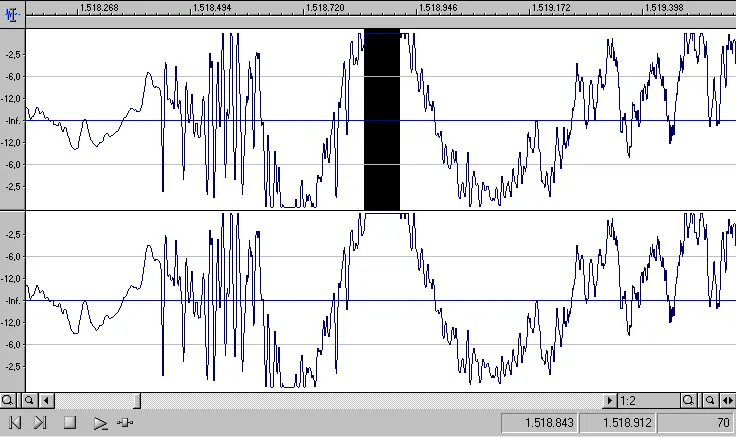

I'm totally confused by that picture
Sorry, I'm afraid I somewhat hijacked this thread. What is shown in the picture has admittedly only little to do with the original question fenix has asked. So, there are basically two different discussions going on. One about clipping as a means to master even hotter and one about a strange waveform.
I was trying to find examples for the clipping that fenix was talking about and had a look at the Audioslave record, as I recalled it being pretty hot-mastered. So I looked at one of the kick drum transients (as these are usually the most squashed) in SoundForge and then posted what I saw, because I've never seen something like this before.
Originally posted by bleyrad
... i'm pretty sure that clip only represents an extremely small fraction of a second.
What we're dealing with here is only 31ms long! So it's really just the transient being fucked up.

A couple of points:
Do mastering engineers clip things on purpose? Nope, definitely not. However, there are SOME occasions where clipping might occur in a number of consecutive samples, to low a number to affect the audio. In that case it will depend on the mastering engineer. He either lets it ride or he won't.
Second - and I believe this is a very important point. I have, on many occasions, mastered a track (and, as we commonly do here, used analyzing software to detect any possible clipping), and, even tough the track was perfect, found that once the CD is burned - it clips. This would be a master disk, burned at high accuracy. Guess what happens if such a track goes through a duplication plant? The clipping would be worse.
I am dealing with one such thing at the moment - the opening of a track clips out, only when transferred to a CD - it does not happen at its original 24/96 state, it does not happen when converted to 16/44.1, but always on a CD, even with the part eq'd and reduced in volume. The reason? Its not clipping.......it a harmonics issue the CD format cannot deal with. That simple. A number of tones / frequencies and waves which, when put together on a low-resolution format, cause distortion. As it’s not possible to pull the elements of the mix apart in mastering, the only solution is to return to the mix and fix it there.
Furthermore – I am incurring more and more examples of a duplication facility basically fucking up. Some lunatics seem hell bend on “upping” the levels at that stage and boosting them. Even a 0.1dB boost in levels might lead to clipping. I always ask for a sample of the glass master for approval and have returned 4 in the last 2 months for “inaccuracies”. In other words, its not always the ME’s fault, there can be many reasons.
For instance, I receive a whole bunch of tracks with tops so square you could stack them 50 high – for mastering.
Next one. The “flat tops” as seen in the examples. Don’t forget this does NOT have to be clipping, it simply can be a limiter. I’m doing some dance/trance stuff at the moment, and I can guarantee you that the tops are all flat due to the huge amount of processing on the kick mainly, but it does NOT clip out on a disk, its simply the waveform.
Finally the “saw” wave on the audioslave kick. Its virtually impossible to tell you exactly what caused it, as you took the sample of a finished CD. However, it is very likely the effect of wind on a dynamic microphone placed in a kick drum. Most dynamics do not have the capacity to withstand the SPL a kick generates, but despite this they are used to catch the attack. The sound will be captured but a microsecond later the sound will be followed by wind, which then creates a pressure level on the diaphragm which it is not capable of handling. This can lead to a saw-like waveform, which is not necessary detrimental to the overall sound (still……………I’d rather do without it). There are now many good solution available to avoid this, like for instance AT’s AE2500, the dual element kick mic, or, even better perhaps, the superb Russian build kick drum mics from Elation. (the latter, in a matched pair inside the kick, with the Yamaha sub-kick on the outside, produce the best sounding kick I’ve ever heard, without any kind of processing.

hold it a minute here!
i think there is some confused information going around.
- In the digital world, there is no such thing as an 'over.' A clip IS A FLAT TOP at 0db. they are one and the same thing! Put simply, if digital software sees a level greater than 0db, it shoves it back down to 0db. That's it.
- To the claim that a wave with 90% flat tops will have "no distortion": this is impossible. Flat-topped waves ARE distorted by their very nature. Think synth-generated square or saw waves. Although it is based on a pure root sine wave of a low frequency, its shape naturally contains the sum of many other higher-frequency harmonics. Those harmonics are 'distortion', and that is EXACTLY what a digital clip (flat-top) does - turns a round wave into a square wave, which introduces unwanted harmonics.
(there is a bit of an exception to this rule with very old CD players that 'blip' when presented with a 0db signal, but that doesn't even mean the signal has to be clipped! it could simply be the legitimate top of a perfectly fine sine wave causing the incompatibility with the player. this kind of blipping distortion is NOT the same thing as a digital clip.)
- Many legitimate ME's, even really high-end pro's, use clipping very often as a way to increase loudness. turning the top few samples of a waveform square CAN go completely unnoticed, if done right. once again: that's all that clipping is.
The interesting thing about digital clipping is that it's impossible to know what has really been 'clipped' because a 0db sample isn't necessarily one that's been forced down (clipped.) All that those clip-lights tell you is the software's "best guess" - usually around 3 samples in a row at 0db will show up as being clipped. But frankly, I could generate a sawtooth wave with its peaks at 0db, without clipping it at all, and the cliplights will turn on. That said, they're usually pretty accurate.
- The L2 limiter isn't a clipper. It's a limiter. It retains the natural undistorted shape of the waveform, so long as you use it with a long enough release time (or ARC.) You can run it very hard without getting ANY flat-topped samples. To sum up: look-ahead limiters like the L2, when used properly, are not what are causing clips in media. Generally, clipping is done by the ME on purpose.

There definately is some confusion here:)
You are correct that a clip is a flat top at 0dB.
You are however incorrect in stating that all flat top waves are distorted by nature. It is perfectly possible to limit material at a certain setting under odB, but at the same time compress/push it to such an extend that the total creates a flat top. With the right mastering gear you can do that, without creating distortion, but not forgetting that you create a huge blob of sound without any dynamic range whatever.
I am at this moment in the middle of mastering a trance/dance project on the dsd8, a projec that arrived at 24/48. I converted it to analogue and put it through the Pultec / optical mastering compressor chain and returned it into the dsd. This material is intended purely for danceclub use, it needs to be loud as hell, no dynamics required. tops flat - overs, or clips, whatever you'd like to call them - nil.
In other words, there is a difference between a track "clipping" / distorting, and the sum of many tracks saturating the available space up to OdB to the maximum.

how close are you zooming in to look at these 'flat tops'?
i have this feeling that what you're calling flat topped is the overall view of the whole song, or a portion of it, that looks in the waveform display like it's totally maxed out and flat.
if you zoom in to the sample level though, i think you will find that the samples are not all flat.
they cannot possibly be without creating harmonics.
look-ahead limiters and compressors do not create flat-tops unless their release time is too short.
and in any case, if you're dealing with non-look-ahead jobs, or your release is too short, it is distortion, regardless of whether or not it's particularily noticable.
flat tops are clips are distortion. period. that's all there is to it.
