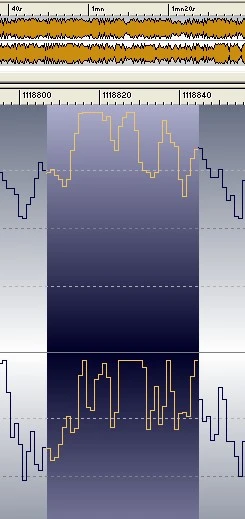

I read in that Bob Katz TC manual that 3 clipped samples of percussion are usually inaudible. Look at the picture attached. Could it be that after limiting of the mix and done, some Mastering Engineers purposely raise the gain of the mix, say, 2db which would clip the wave? They're squeezing out 2 extra decibels and mostly inaudible distortion.
If you notice in the picture, I have zoomed in on a section of a song (a HOT song with an RMS of -7.5db!) with wavelab. The numbers on the top are samples. In the highlighted section, about 4 samples are flattened. Are they clipped? Or limited? If I had to guess I would say clipped. It takes some really really hard limiting to flatten like this.
Clipping and limiting.
Mastering Engineers do a lot worse than that! Your showing a file that seems to still have at least 7.5db average to peak ratio, and that's quite good for todays "loudness wars". I have seen files that go as far as 3db average to peak ratio!
To answer your question as to if the file is limited or clipped? I think it's limited though if there is more than 3 samples hitting 0db at any given time it is also clipped, though it may not show on the meter.
Limiting these days is the norm in the mastering stage if the band or artist hopes to achieve the loudness of todays CD's being released commercially.

Yep, they certainly have the equipment and clients that pay them to do it !
I was chuckling about this thing someone posted the other day:
https://homerecording.com/bbs/showthread.php?threadid=103432
Broadcasters have had clippers for quite some time, I'm not that glad to see it creeping into professional audio I don't really get the point.
Of course when I clip something in my garage I just call it character ! :D

No no no.
I'm talking about would they take the processed track and raise the gain of it. Clipping and limiting are 2 different things.

I think what he's talking about is what Bob Katz refers to as SHRED, and that's quite exactly what fenix said, i.e. raising the level after all the other processing has been done. This results in clipping and should ideally, if at all practised, be inaudible (3-6 full scale samples in a row).
But let me tell ya, luodness war is even worse than that. Take a look at RHCPs Californication, LOTS of shred. Or the Audioslave record. I once looked at some of the songs and there are kick drums with 30-40 samples in a row, flat as a ruler! And I won't have to tell you that that's very audible...
I hope this is going to be the last step in the loudness war, 'cause by now, the customers really get annoyed.

fenix,
I read the spot in the Bob Katz article you're referring to. I think there are spots in there that are a little tricky...
Just before your spot he mentions something about most folks not being able to tell the difference between 10ms and 10us transient. Then in your section mentions a 3-6 sample percussion clip (overs) is usually undetectable. All I can say is try it out and see if that's the case for you. The clipping he's talking about is the bad stuff, digital overs, levels greater than 0dBfs.
I set my stuff to 1 sample over detection when possible - some apps I don't know what their overs threshold is (1 or 3 samples) before a red light gets turned on. At any rate I can always check it with Inspector (Elemental Audio).
Another tricky piece in the same paragraph is when he goes on to say that you can raise the gain by 2dB without using limiters or compressors. He says this right after talking about clipping and overs - and the heading of the paragraph is "Overs Counters and Increased Level". That's kind of an unfortunate to have all that in the same paragraph because digital overs are always bad and you may end up getting a reject from a CD manufacturing house because of it - not to mention you can hear that stuff too !
But when he says you can raise the gain by 2 dB without limiters and compressors he can't be seriously telling anyone to 'push into a clipper' and take 2 digital overs because chances are you can't hear them if they're percussion. That paragraph needs serious rework.
I hope he's telling us - if we don't use limiters and compressors to increase gain then just watch the 'overs' meter as you raise the gain or when you adjust the loudness by altering the EQ.
Yeah, this is exactly what i'm talking about.
Judging from looking at some waveforms, it would apear that this is what is occuring. Even if I take my L2 and slam it at ridiculous levels it won't flat top like digital clipping does.
Over on Bob Katz forum 'Shred' is used as a kind of slang the ME's refer to as over limiting or squishing.

OK fenix, here's some independent confirmation from Roger Nichols (famous ME) ...I was looking for this article earlier.
http://www.rogernichols.com/EQ/EQ_2000_02.html
He's saying exactly what you and Bob Katz said - ME's will push past the digital ceiling a bit allowing overs (the most absolute digital limiter possible I would say) and then have the pressing plant back the volume down about .1dB or so to prevent overs (once the wave has been sawed off). That's exactly what your wave looks like, sawed off and backed down a bit.
Just as a caution - in case anyone is reading this and wants to try that at home. Ha Ha ! I recently re-balanced a project for a buddy of mine (in Cincinnati no less!) who had pushed across digital 0dBfs due to some technique issues. It's really tricky if you do that and in certain cases unrecoverable, in other cases you can get a cool sound (just make sure you don't send anything to a DAC with overs though - you won't like it !). Just keep a safety copy of your tracks incase downstream a bit you don't like the sound and want to remix. Best thing is to control yourself and stay under the overs while recording and mixing - there's other ways to get that sound.
As fenix found out though the pro ME's will do it to adjust loudness - Ha Ha must be a good thing, eh ?
