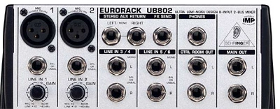

Here's a pic of your mixer. Which line inputs are you using?
If you are using HI Z/impedance mics, you might be able to plug straight into line 3 and 4 and hear something.

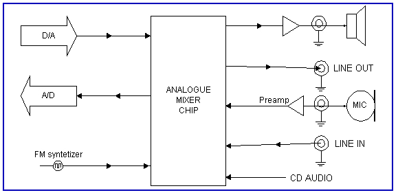

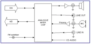

Wait a minute. Wouldn't sound cards have some kind of preamp in them? After all, you do hook computer mics into them.
I don't know diddly about soundcards, but I think that generally line inputs in electronic devices may have buffers and attenuators but not amplification.
The mic inputs of soundcards do have preamps, but in consumer grade soundcards are generally crappy and not to be used.
Here's a block diagram of a soundcard for perusal.
