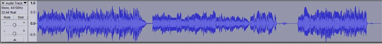

Also, what is my dbFS in the photo shown in the attachment? The maximum is only 1 and my recorded track has volume on average 0.5, is it normal?

Don't know what DAW that picture comes from, but that is a GREAT looking signal. No clipping, everything right with the world. You've got a good noise floor and adequate headroom.
-20 is less, but your DAW is not showing dB meter, showing digital (0-1).
You could post an audio sample for us to hear, but this is not hissyfit stuff, meaning, if it ain't hissy, don't have a fit. :D
You've got a good signal. Take that into a mix. Push the mix around, EQ and effect where necessary. Then hit the MP3 clinic and let's see what it's like!
No, the point is, that is a perfectly acceptable looking signal. You've done a good job miking your harmonica.
