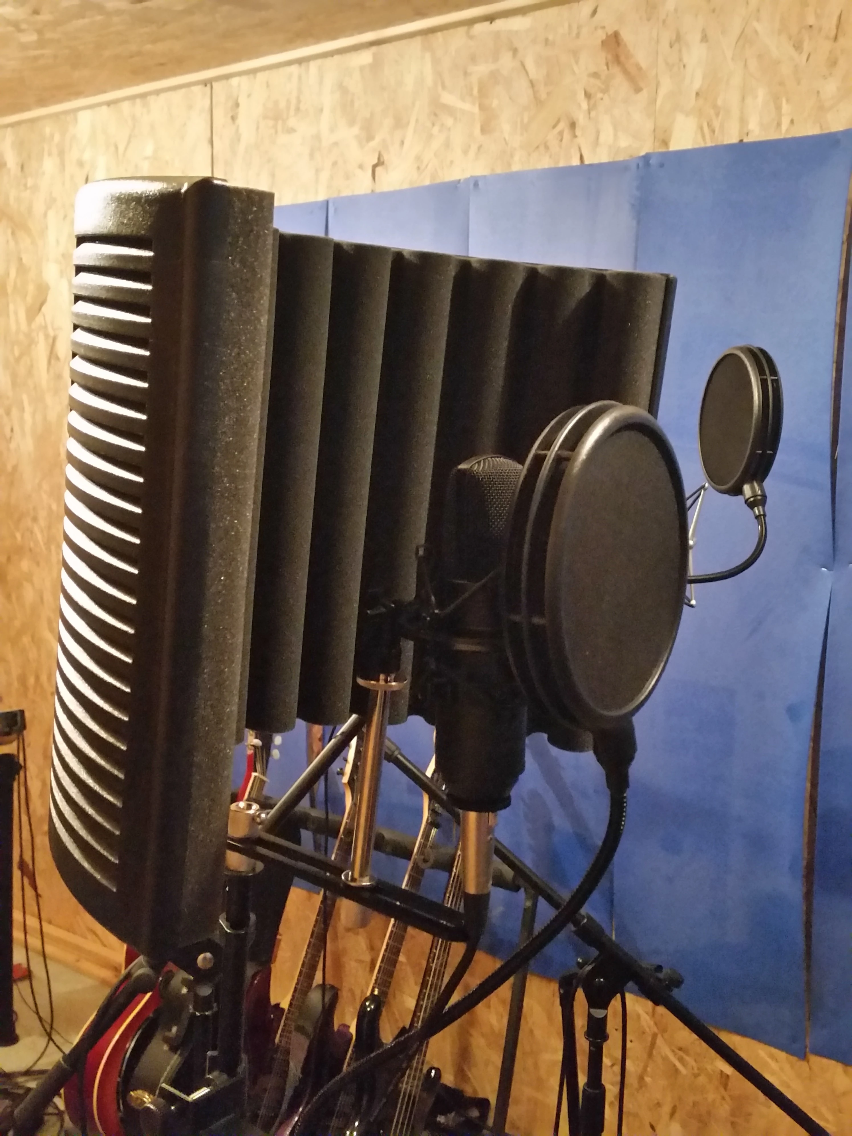

I have the one Chili linked, it made a difference in cutting down on the room reverb bouncing back into the mic.

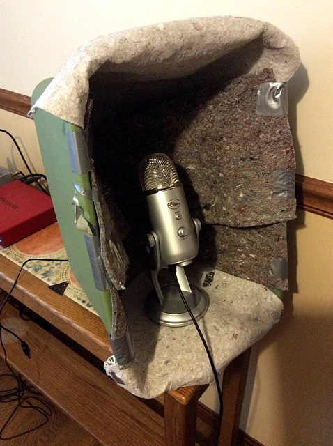

If your husband is a DIY person, here's a an idea I picked up from a professional narrator. It's a quick experiment using on hand materials. A better looking version would use foam and spray adhesive, not duct tape and insulation left over from my wood floor installation lol. But you get the idea.
Doubles as a carry bin: if the foam were glued inside and trimmed, the lid to the bin would snap on, and the foam would cushion the Mike and cables inside when stored and transported.
That might cut down on some of the room reflections, but chances are it's going to sound boxy AND boomy - foam does not absorb low and mid-low frequencies. You would probably get better results by facing out the long way into a room and having a thick duvet or comforter hanging behind you.
