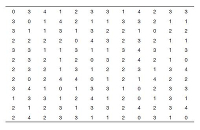

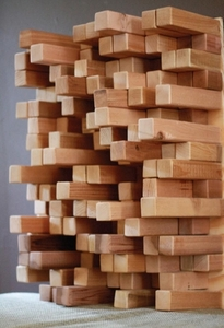

R Rod Norman New member Sep 26, 2014 #21 Here's a guide to making a good diffuser. I use 2x2 inch wood. The numbers in the diagram refer to the length of the piece in inches.
Supercreep Reclaiming my Time Oct 21, 2014 #22 In a small room, diffusers aren't going to do anything useful except look cool.
mjbphotos Moderator Oct 22, 2014 #23 Supercreep said: In a small room, diffusers aren't going to do anything useful except look cool. Click to expand... And collect dust - they look like a PITA to keep clean.
