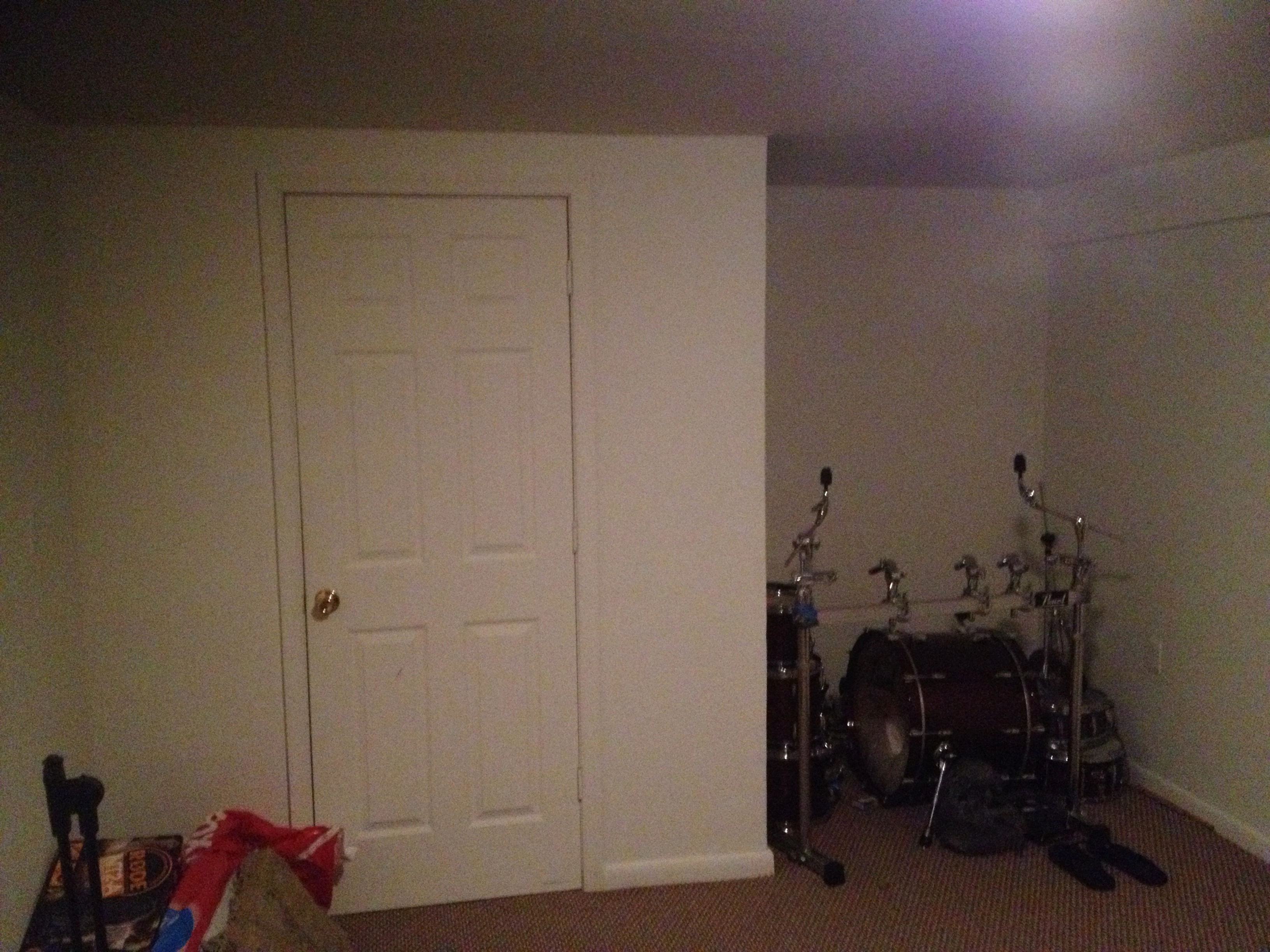

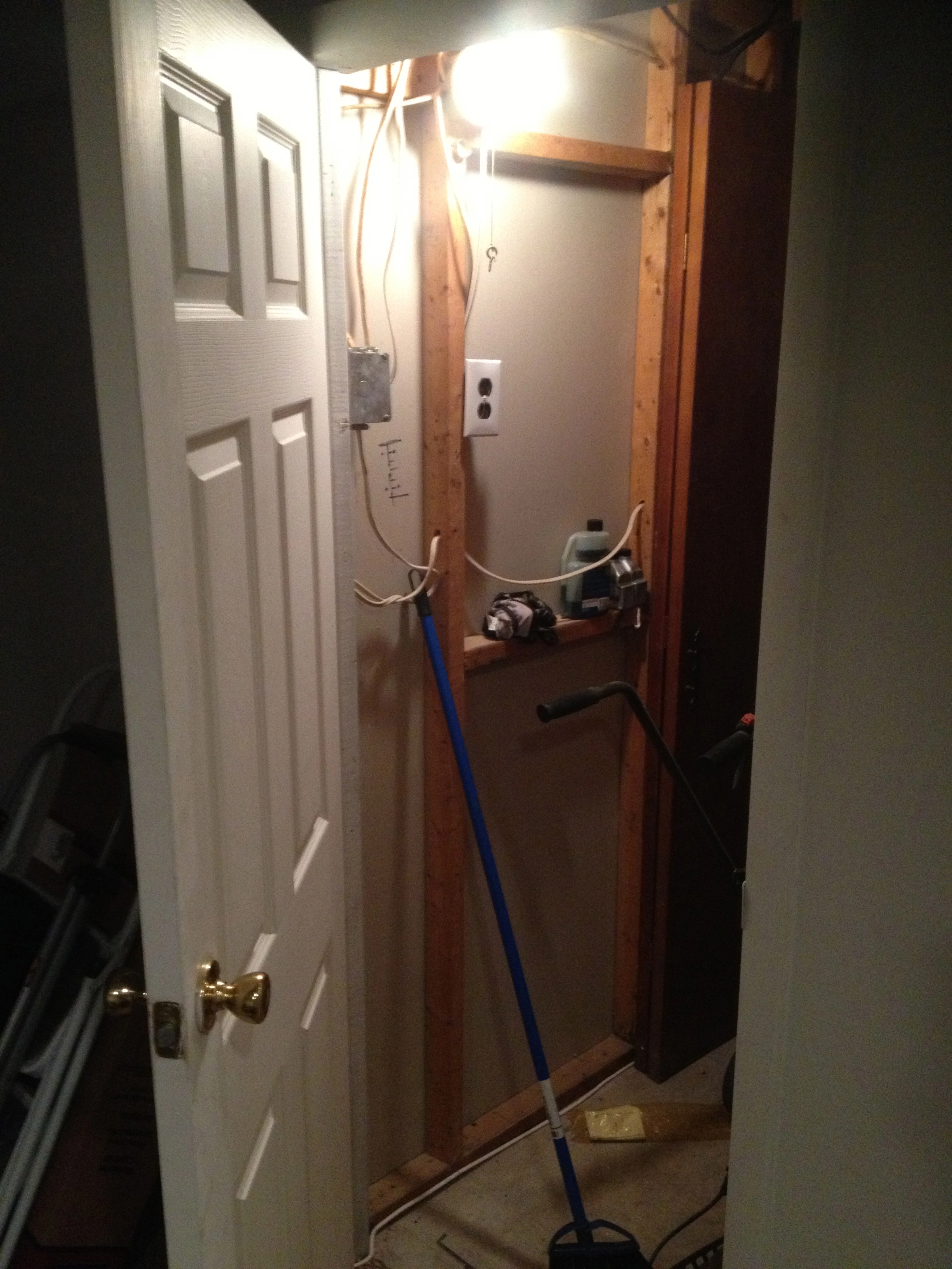

My room is 11x15 with my speakers facing the longer part of the room. Directly behind me is a closet that is 3x6 that I really want to turn the into a recording booth. My plan for this would be too bring the closet out another 2 ft and extend the closet to the right wall. This would make my booth 5x11 and my control room 11x13. I was thinking about adding a window into the booth, but I am concerned about doing this because of the fact that the wall is directly behind me and I don't want any direct reflections. I have done some research on this and read many things about angling the wall and the window. The problem with this is that I have probably read just as many saying that doing that doesn't help and that it is simply a myth. I find this strange since they say sound and light are comparable in the way that they reflect. So if light hits the window on an angle reducing glare, wouldn't it do the same to the sound? If i were to angle the back wall and window, would I have to angle the other walls for it work more effectively? I plan on removing the door and walling it up and having the entrance to the booth outside through a closet, as shown below.
The door would be right where the light is to get into the booth. I figured this would be better for leakage issues between the booth and the control room. I also plan on having a love seat in the control room and I am not entirely sure where I should place that (suggestions). The sound panels that are up are the only acoustic treatment panels that are in there. I made them at home with rockwool, wood and used burlap to cover the front. The ones on the walls are 2.5 inches out and the one above my seat hangs down about 5 inches from the ceiling. I want do build more and do something with the corners as well but would appreciate some advice on that. Also, considering the small room, should I be worried about diffusion or just stick with the broadband Absorbers? If so, how many panels would be too many? I have also looked into buying something like genie clips, more rockwool and doubling the drywall for the ceilings in both rooms and the dividing wall.
