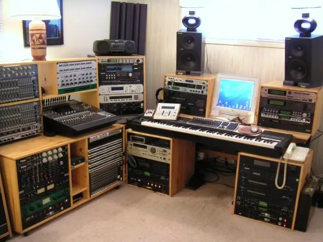

You really don't need to find a diagram, as racks are the simplest thing in the world to build. If I can do it, anyone can do it! There's just a few measurements to keep in mind.
Each rack space is 1.75 inches high. So if your rack will be 12 rack spaces tall then that's 12 times 1.75, which equals 21 inches. Width is 19 1/8 inches. These are the *inside* measurements.
I always leave a little extra space at the top and bottom of the rack for the gear to breath and a little extra comfort zone so the gear won't be too tight. I'll leave and extra 1/8 inch or so above and below the rack rail. So you'd add that to the 21 inches in the above example about the 12 space rack. The inside height measurement would therefore become 21 1/4 or 21 3/8 inches.
The depth of the rack is whatever you need it to be, but I make my equipment racks 18 inches deep. I also recess the rack rail a bit, like around 1/2 an inch.
This is really all you need to know. When I build racks I just sketch out the design with the measurements on a piece of note paper.
You can view my racks in the attachment below.
As you can see, they are very simple. Nothing fancy, just basically boxes for my gear. But they are very space efficient and were low cost to build.
