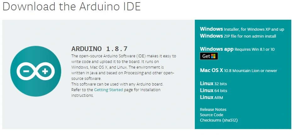

Refer to the original article on installing the arduino IDE framework, and the teensy loader app. But use the links below for the current versions, which is what I'm using.
Download arduino IDE 1.8.7https://www.arduino.cc/en/Main/Software for your OS
(I downloaded the Arduino Windows Zip file and just unzipped it to my desktop.)

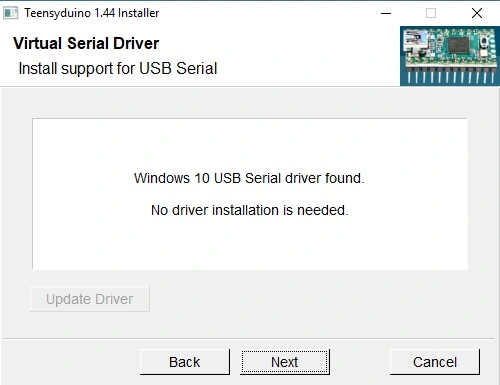

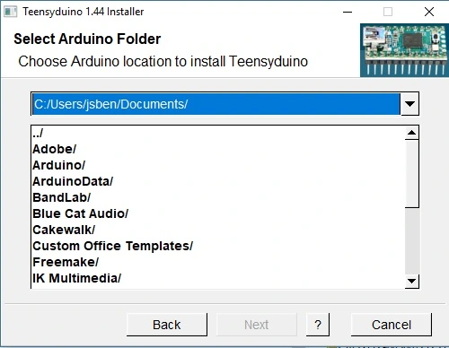

Download the TeensyDuino Add-on for the arduino IDE framework.
Special note on Windows 10 installs - Windows 10 already has the drivers installed. Just click Next when you will see the following page...
On this page, browse to where the arduino app is located. I unzipped my arduino folder to the desktop, so my path is "C:/Users/jsben/Desktop/arduino-1.8.7-windows/arduino-1.8.7/".

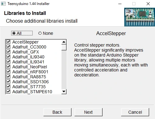

On this page, you're installing all the libraries, so just click "Next"

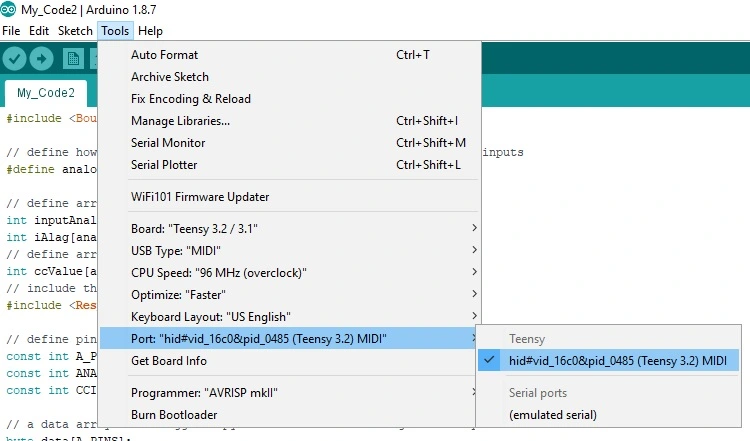

Using the Arduino Application

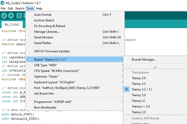

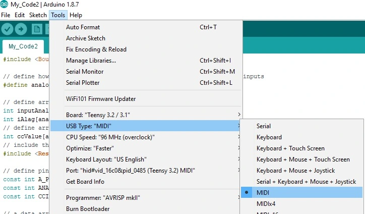

With your Teensy board connected via USB, open the arduino app.
  1. From the Tools\Board menu, select "Teensy 3.2/3.1"
  2. From the Tool\USB Type menu, select "MIDI"
  3. From the Tools\Port menu, select your connected device (it'll resemble mine)
Copy the code below into the blank window

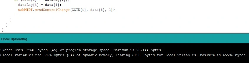

After updating your code, click the arrow button at the top, to write the code to the Teensy board
The little Teensy app will pop up on the screen, and it'll say "REBOOT OK" and then "Press button on Teensy..." Just ignore that. After the code is done, you can close the window. You'll know the code is done from the status window at the bottom of the arduino app. It takes about 10 to 15 seconds to run, and should look something like mine when done...
When you're done, and want to save your code, you'll get prompted about needing to save it in it's own folder. Do the obvious thing, and create the folder, and save the file in that folder.

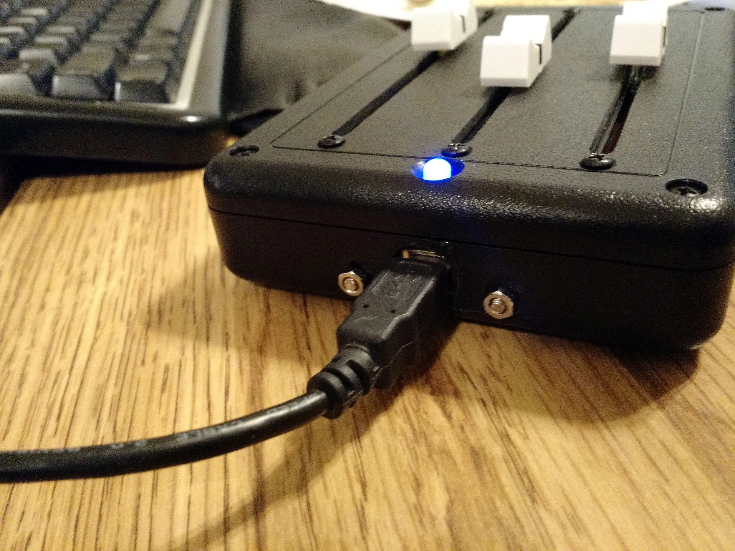

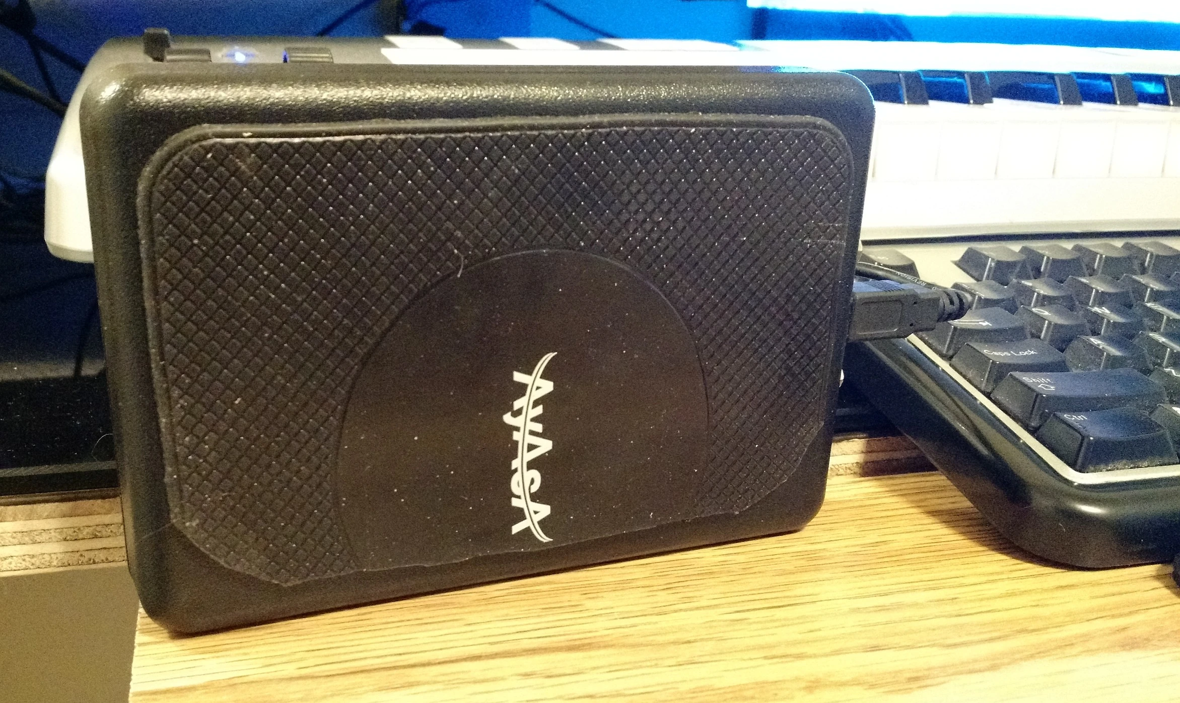

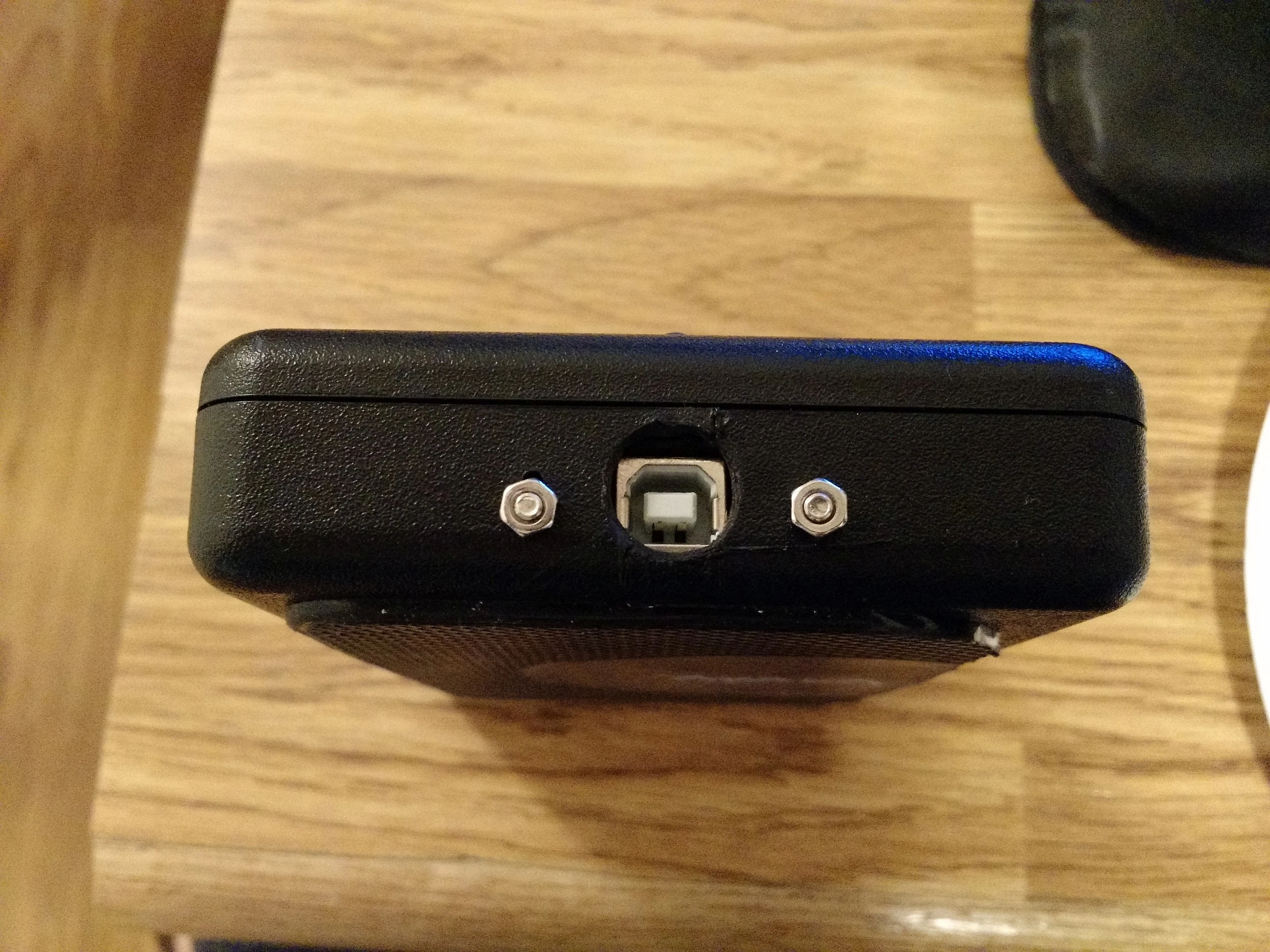

Just a few various pics...
Here's a pic of the car dash-mat I trimmed down, to keep the unit from sliding around. It stays in place incredibly well, and is lower profile than feet would be. It doesn't cut or slice very well at all, but no one's going to see it anyways. Smooth side of mat goes on the case.
Here's the jack hole (if your inner-child starts to laugh, it's perfectly acceptable :D). I didn't bother cutting a square since it won't be seen, especially with the USB cable attached.

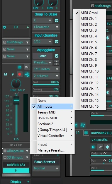

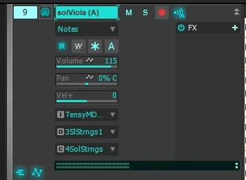

DAW Setup

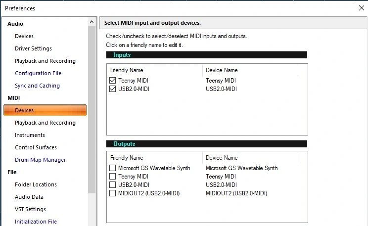

In your DAW preferences, you should see the Teensy MIDI board. This is Sonar...
Select a MIDI track, and make sure either "MIDI Omni" is selected, or the "Teensy Omni" at a minimum.
Start moving the faders. You should see your MIDI input levels rising and falling with the faders...
If you're not getting a signal, go into the preferences, deselect the Teensy board, and hit Apply. Then, enable the board and Apply. It should be working. If not, we need to make sure the computer is getting any kind of signal.

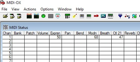

Download and install the free app MIDI-OX. This is a great tool for analyzing MIDI devices.
Note: You have to close your DAW software to run MIDI-OX
In MIDI-OX, display the "MIDI Status" window, and start moving your faders. You should see some activity on the cc channels you've assigned to your unit. My three are 11-expression, 1-modulation, and 21-used by SpitFire for vibrato. On the top row you'll see values for my three faders. You can use many of the other tools/windows to determine if the controller is transmitting a signal, and what port, if any, it's connected to.
If you're not getting anything here, then go back to the start of the setup, and go through the steps again. If you're able to see, and flash code, to the board in arduino, then you should be seeing something in MIDI-OX.

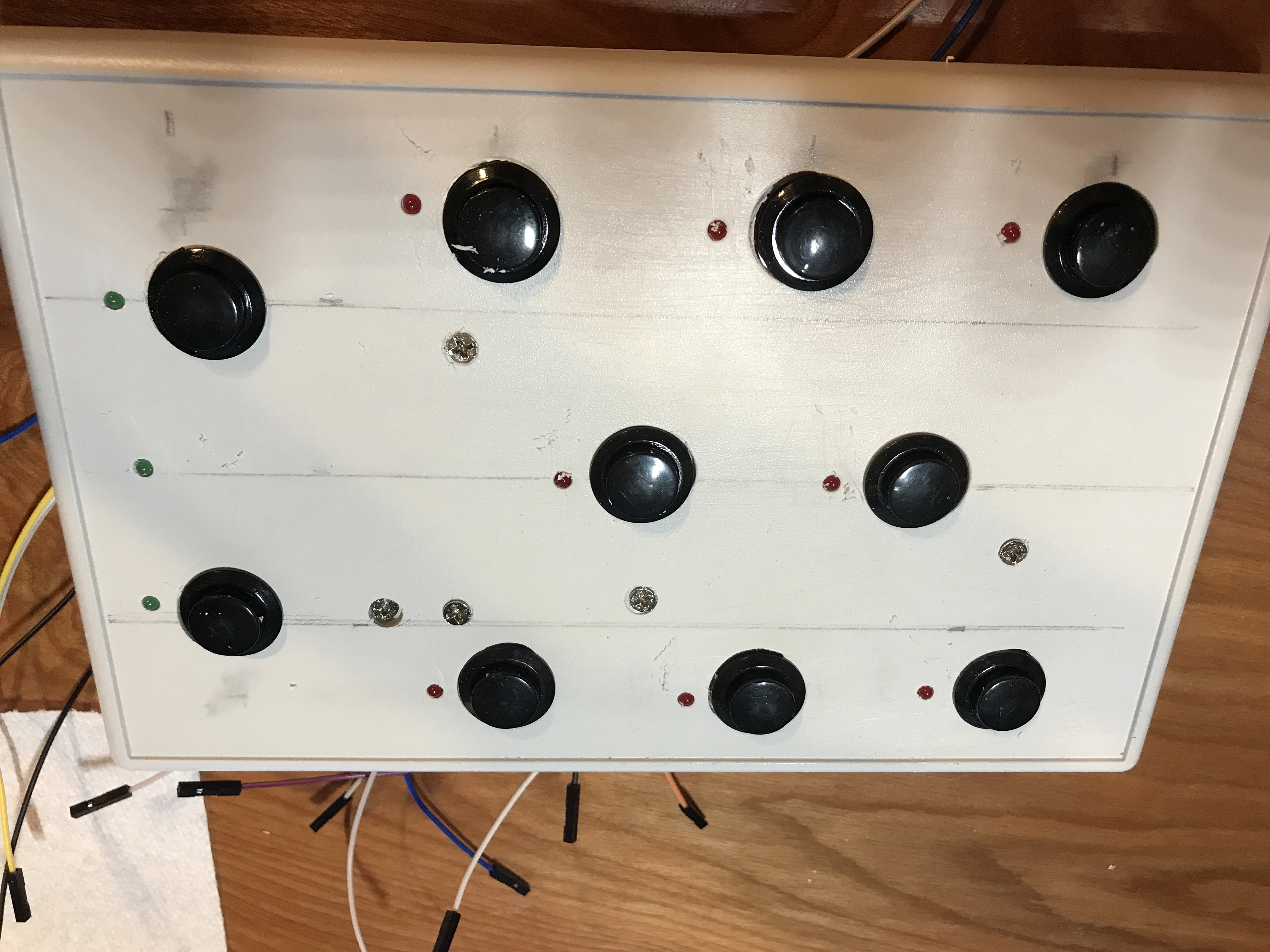

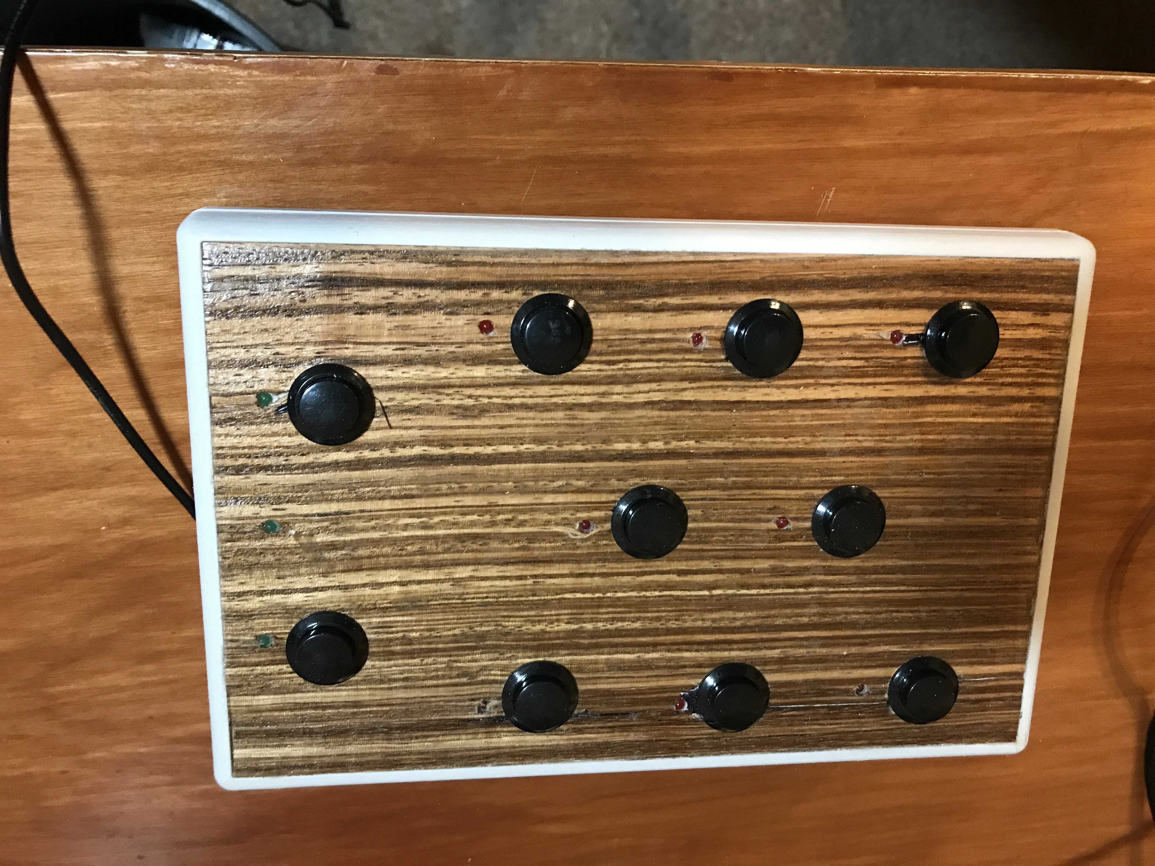

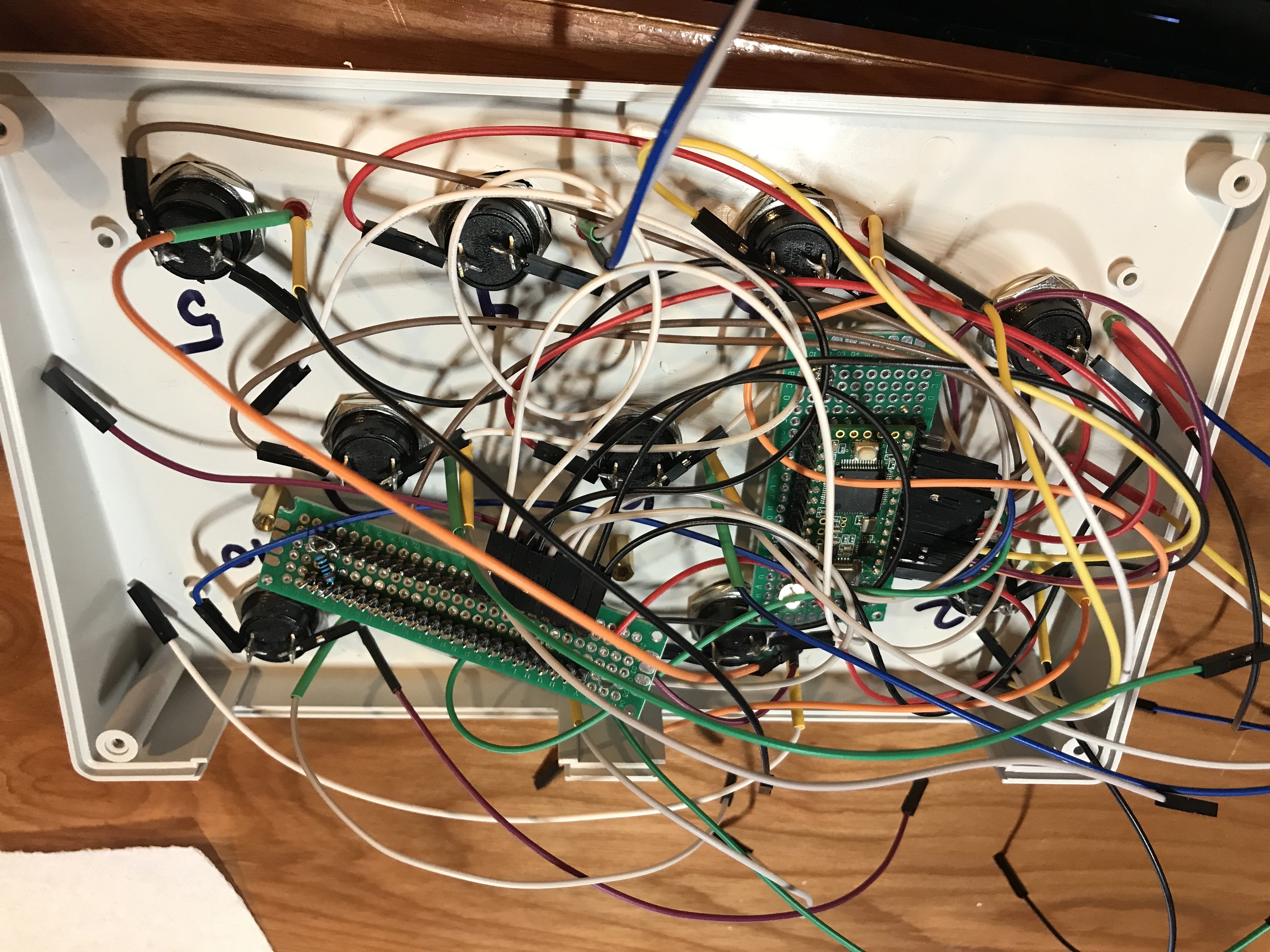

Funny this thread popped back up, I recently finished my MIDI DMX light controller. I used the Teensy 3.2 board, a few switches and LED's. There was code already written for the board, but I learned some of it then customized it to fit my purposes.
The second pic shows what my brain must look like at times. I didn't cut the wires to length nor wrapped them up into bundles, just let them go where ever. I mounted the Teensy board then built a bus board for all the grounds. The LEDs need a resistor and since only one or two LEDs are lit at any one time, I needed only one resistor. So, one side of the buss board is for LED ground, then the resistor connects them to the the other side where all the switches are grounded.
When I was done, I put a zebrawood veneer on it. I should have veneered it before cutting all the holes, but I didn't think about it then. The two switches on the right are page switches so I can page through different groups of presets. There are three green LEDs for the pages and the switches cycle up or down through them. Then each preset switch has its own red LED. Eight preset switches and three pages gives me 24 presets.
The unit sends Note On events through USB to my laptop which runs QLC+ DMX lighting control software. The software sends DMX control through a USB to DMX controller which go out to the lights.
I've used this unit for a couple of gigs already and it worked quite well.

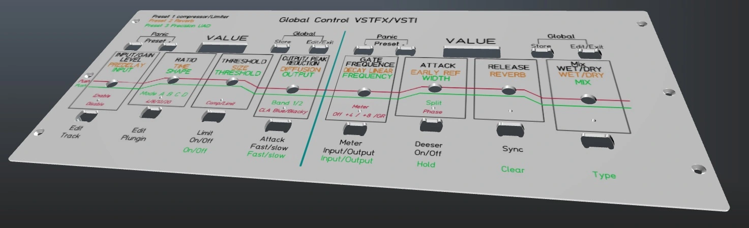

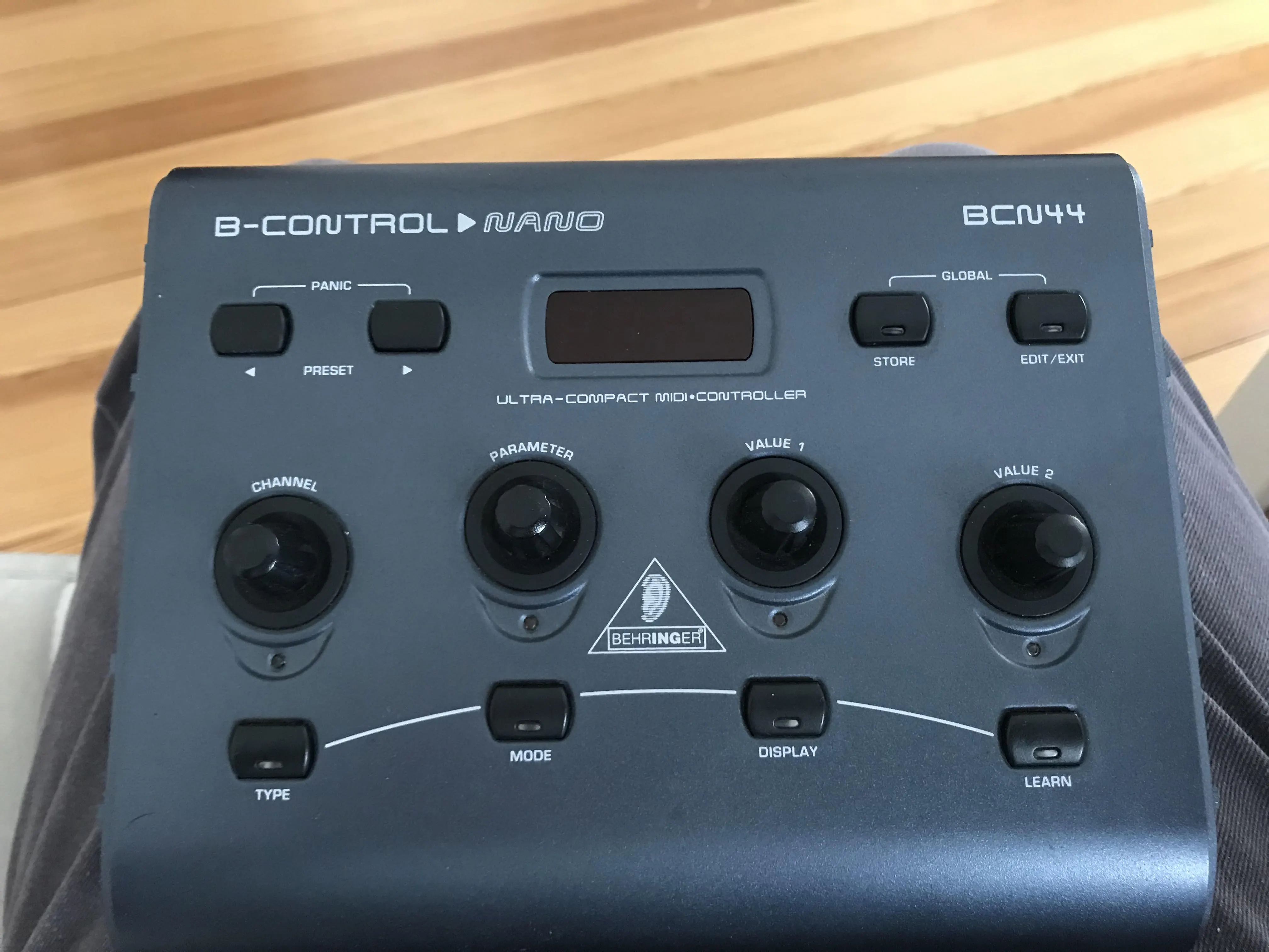

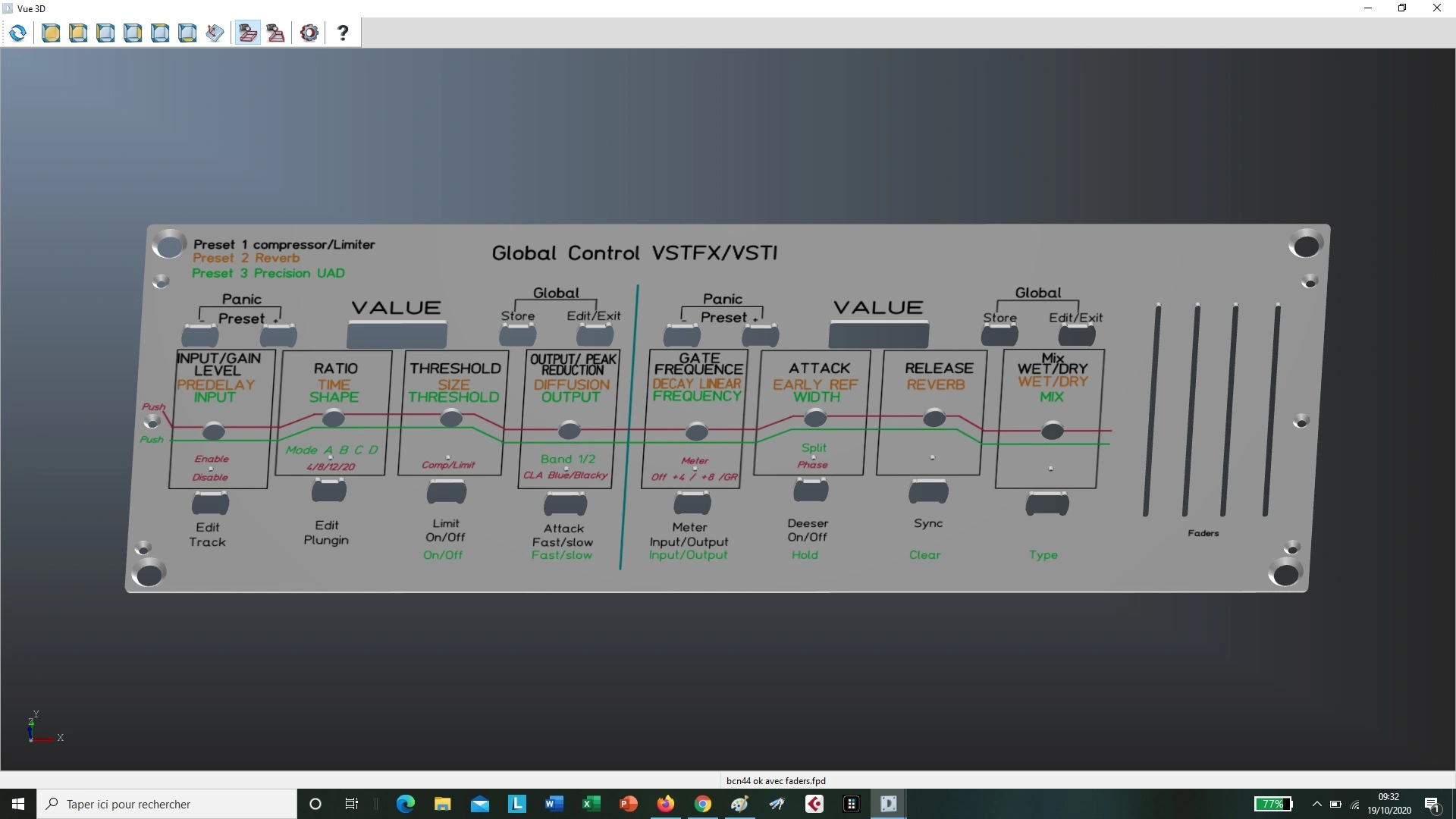

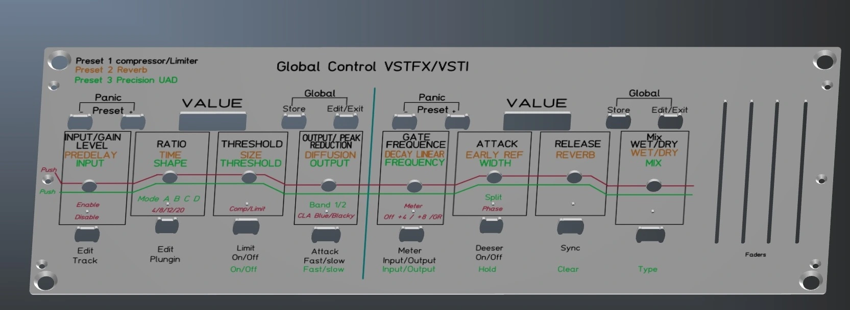

vue 3D de la personaisation de deux bcn44 panneau avant V1.03.webpvue 3D de la personaisation de deux bcn44 panneau avant V1.04.webp

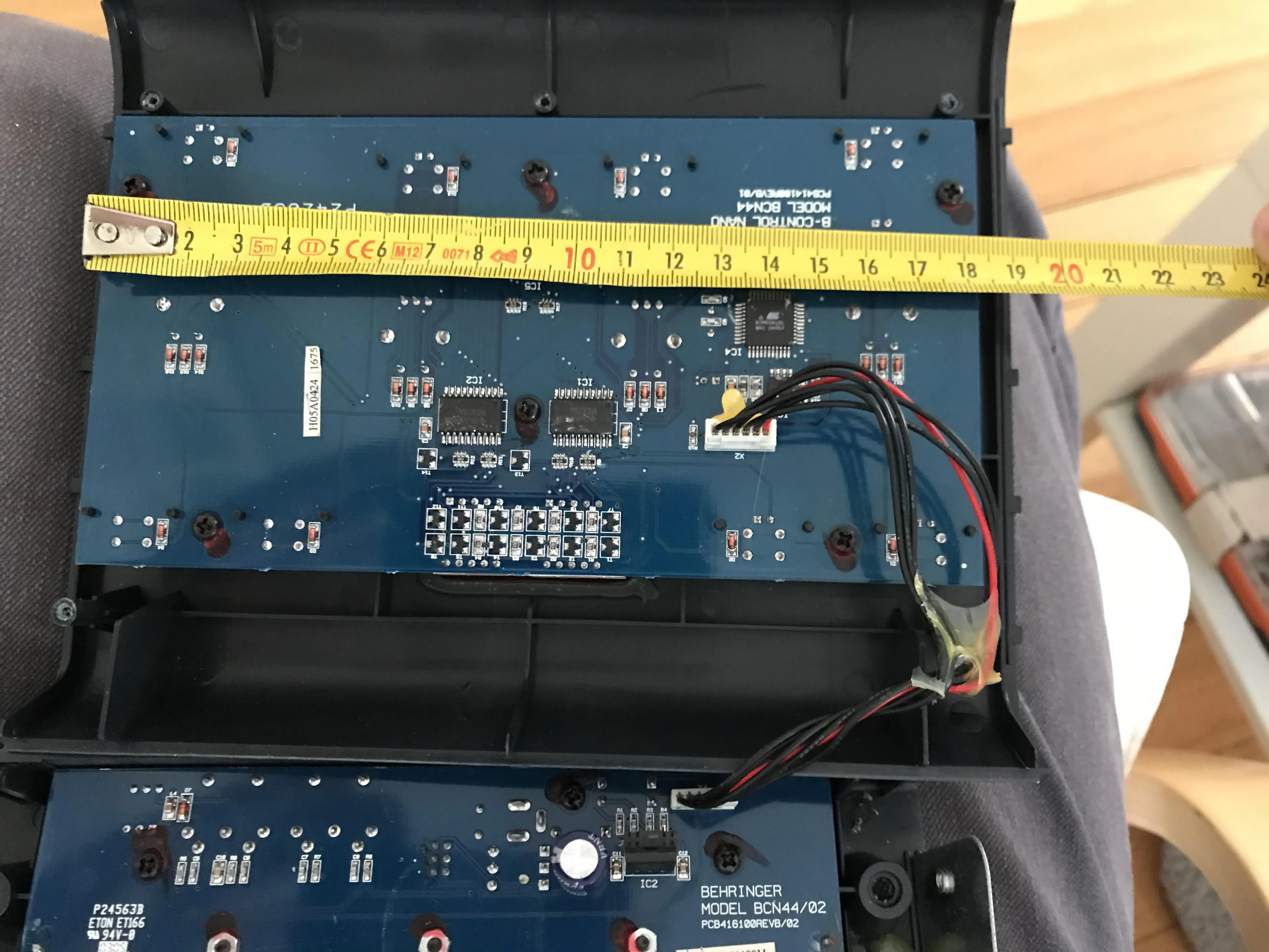

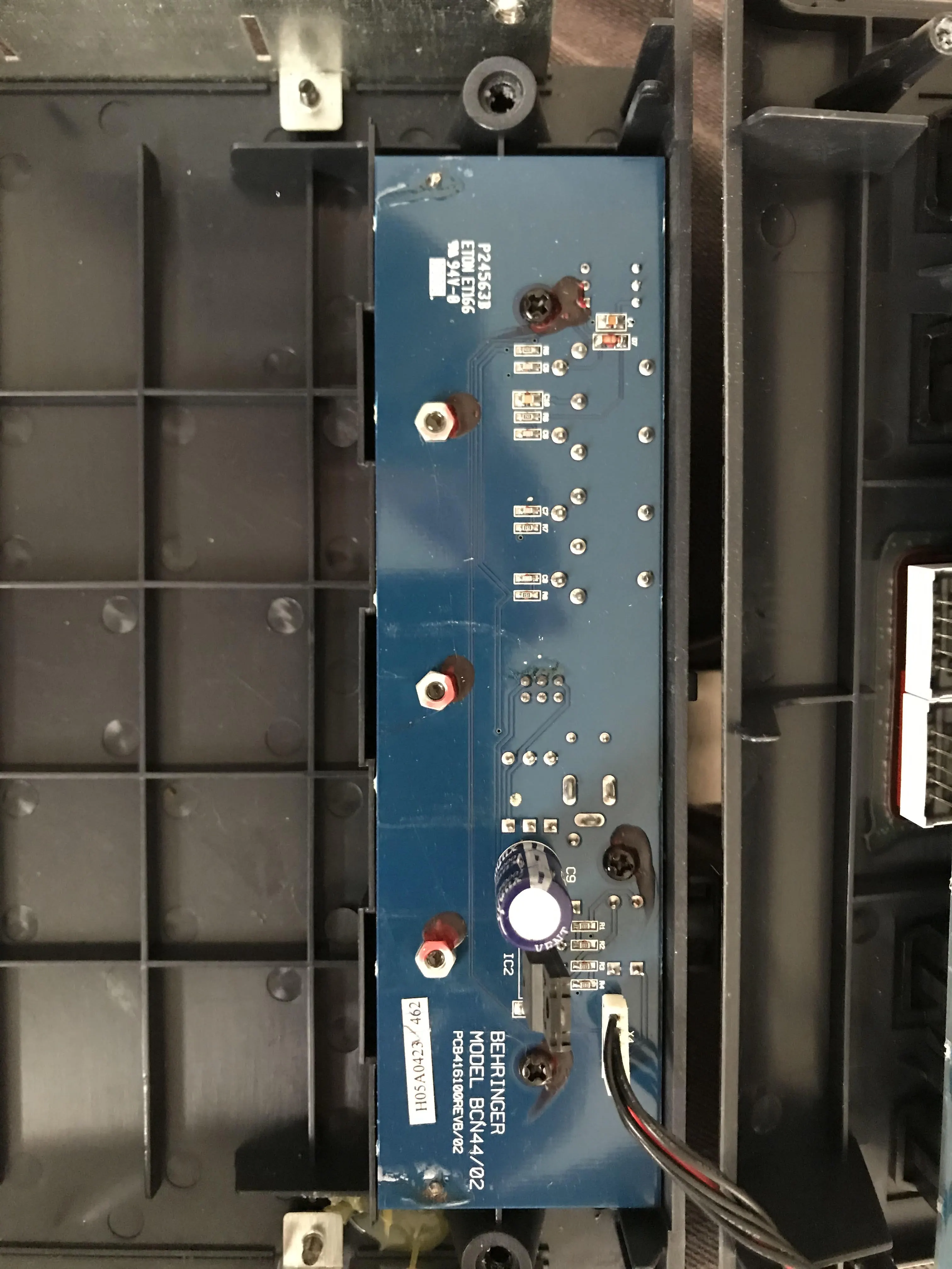

I am using two behringer bcn44 coupled together for this.
I have many questions.
can we put motorized faders. if it is possible how to weld them? how to change the program so that it is NRPN and not CC midi? I don't know anything if someone can help me
bcn44 interface midi vue de dessous.webpbcn 44.webpPLue éléctronique 1 avec le metre.webp
