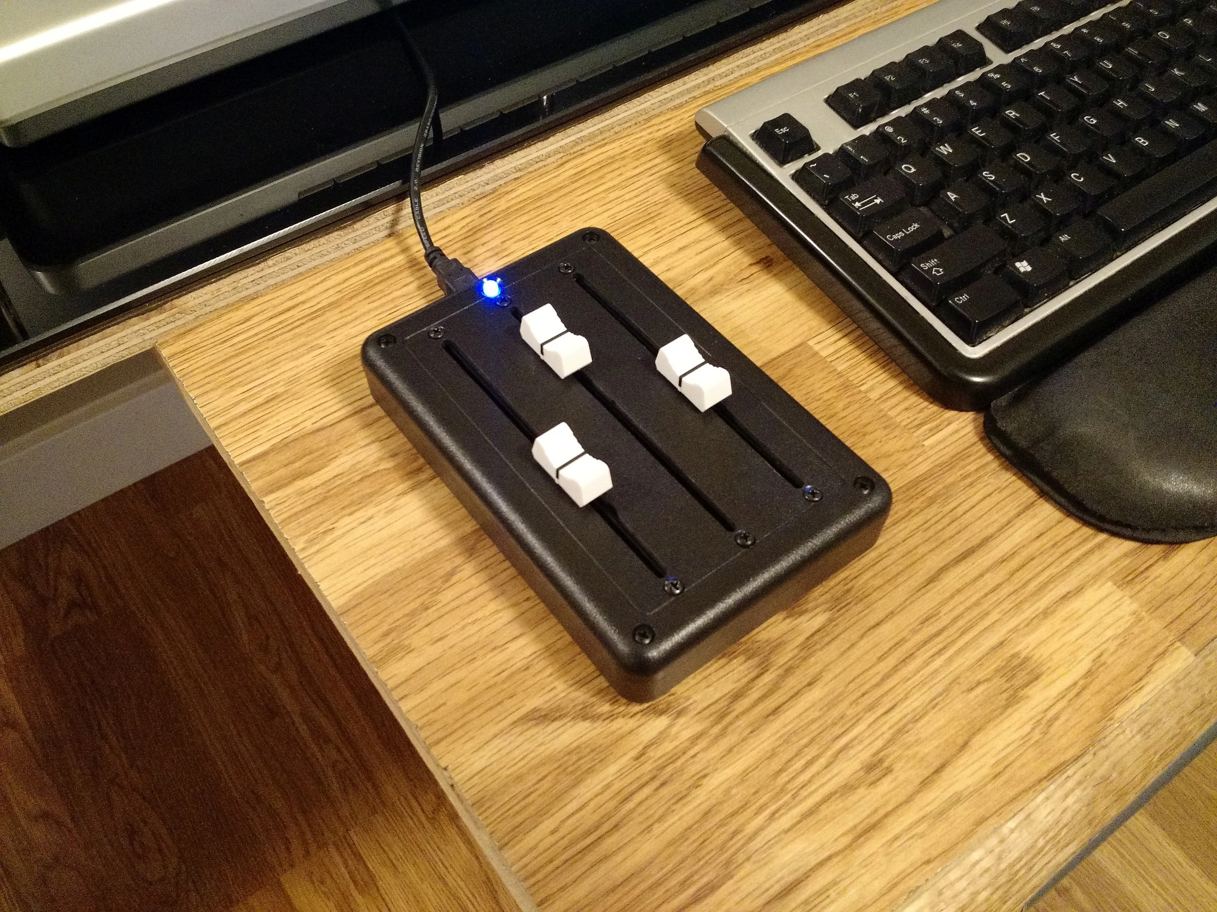

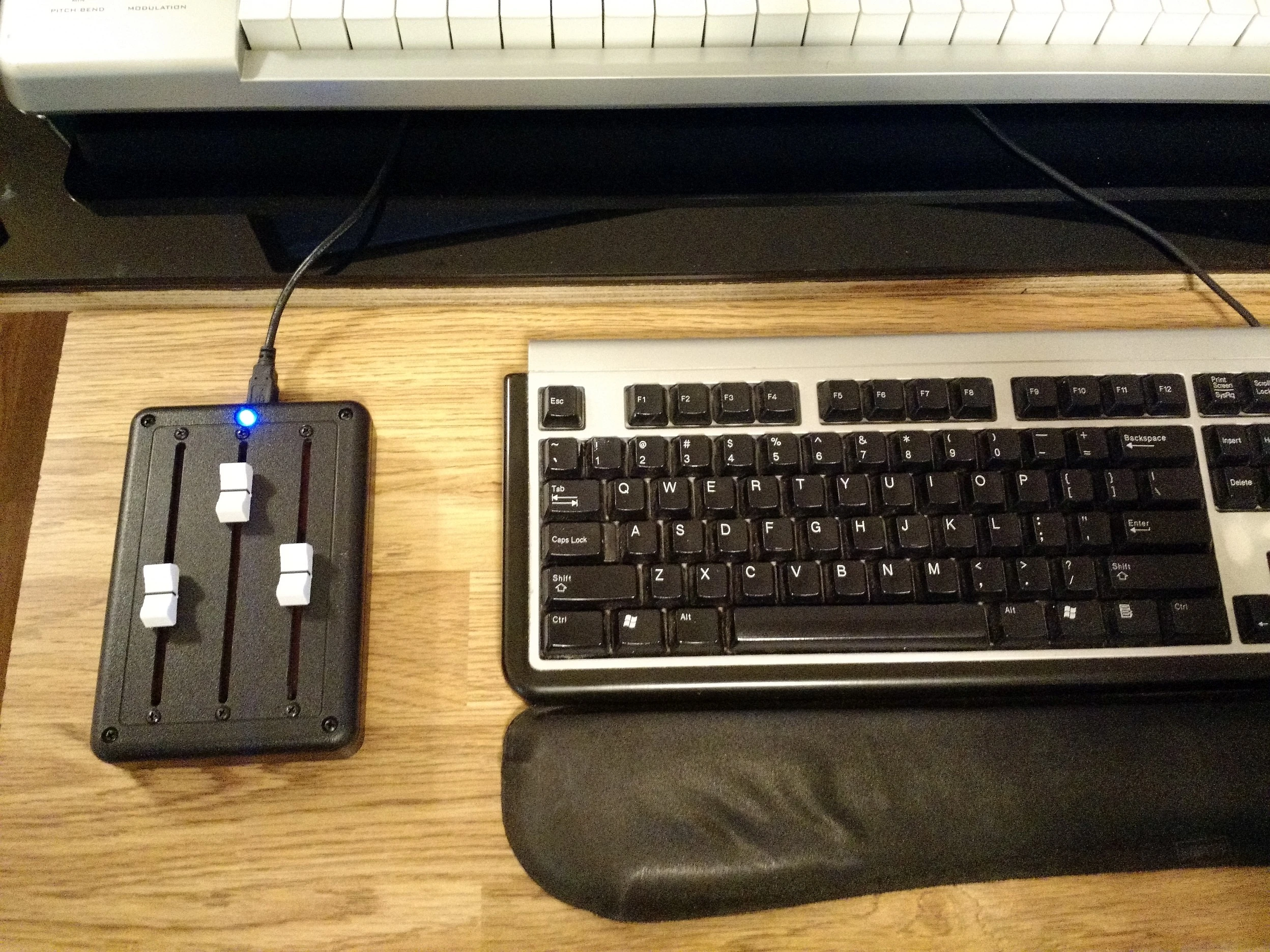

I built a 3-channel, programmable MIDI controller, for between $100 and $120. It works awesome! The detail from the 100mm slider pots is great! I could've added some pan pots, buttons, and other stuff, but what I really wanted was the one I built. I'm using it to control cc11, cc1, and cc21 (expression, dynamics, and vibrato) with some of the SpitFire strings and winds.
I was inspired by this post, but had my own ideas on building it. Mainly the wood case. I wanted something that looked professional, and be low-profile so I'm not having to hold my whole arm up to ride the faders. I used a dash mat, for a car, to keep the unit from sliding around. It really keeps it in place.

I'm using this in the most current version of Cakewalk by Bandlab (formerly Cakewalk Sonar). It works flawlessly, and will work the same on any DAW.

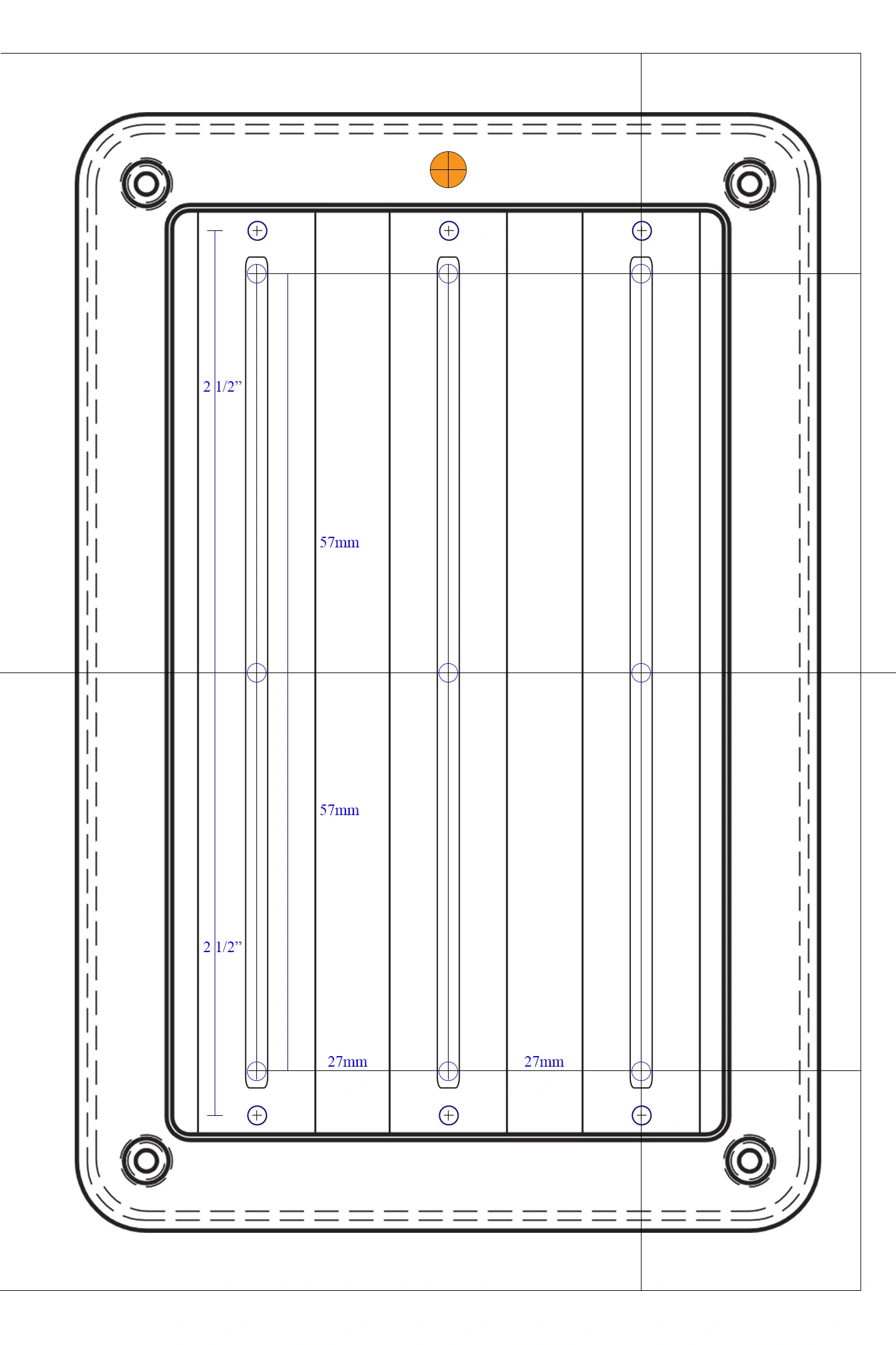

I made the template in Photoshop. When you print it out, it will print to the actual size, and is very accurate. You can edit the PS diagram for your own box. Link is below. If you don't have Photoshop, the jpg is the same. I'll explain the outer lines and everything later.
PhotoShop Diagram
JPG Diagram

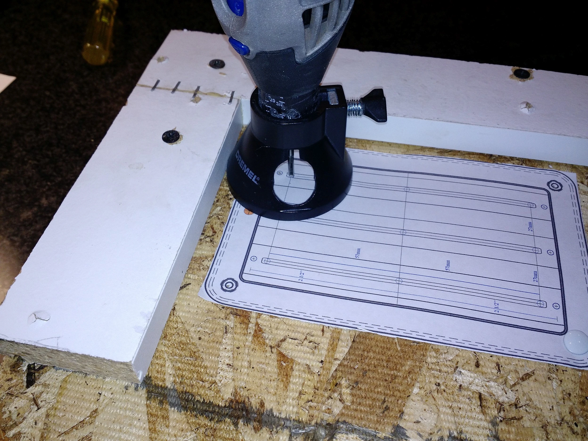

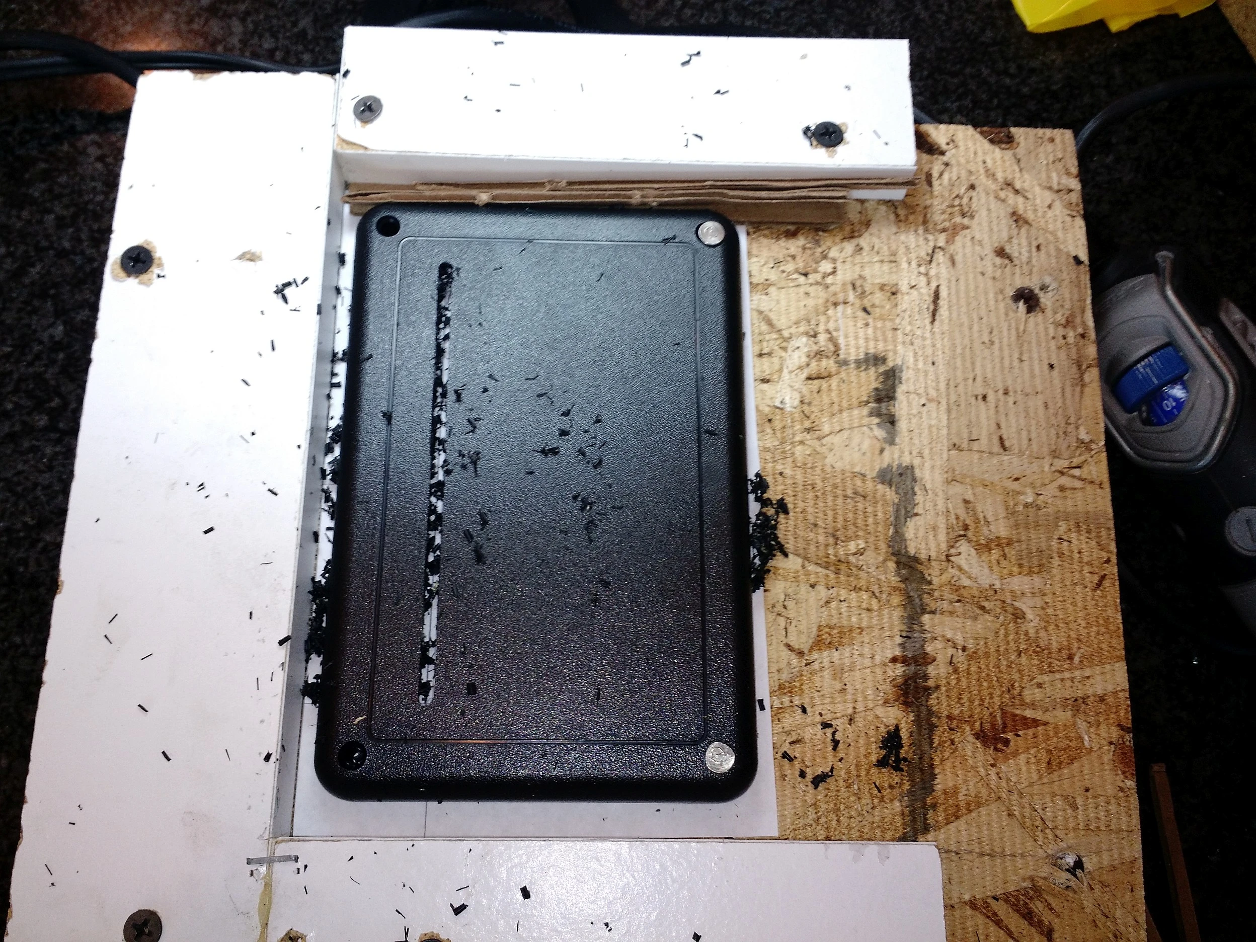

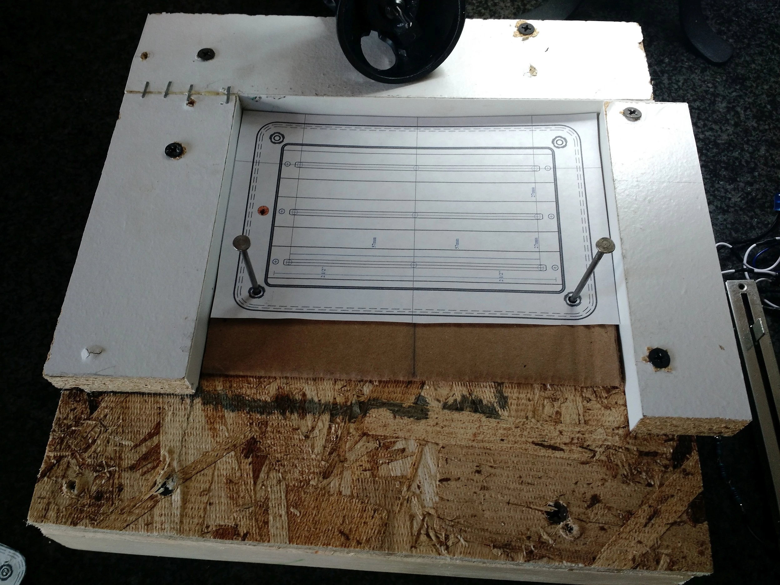

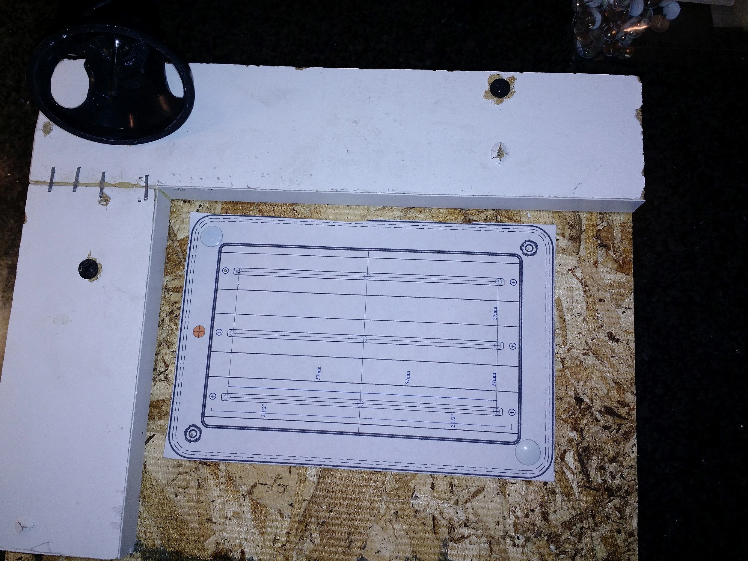

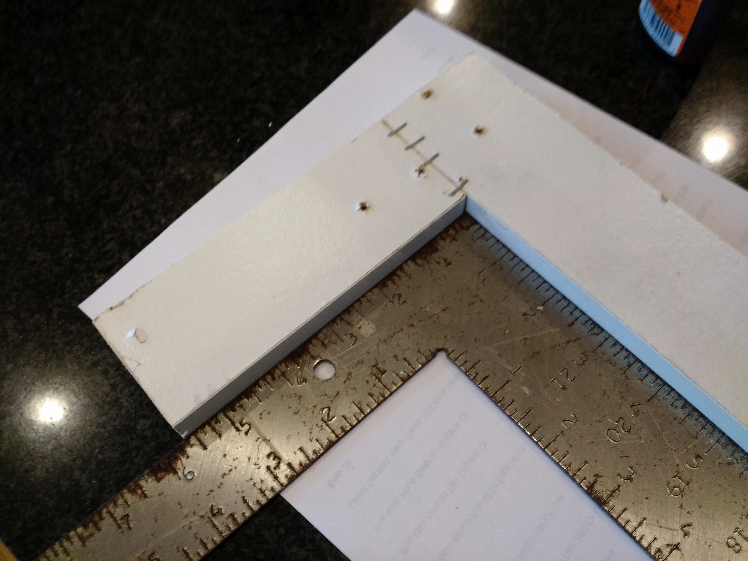

Here's the box being built. It's 29mm from the outside edge of the router attachment, to the router bit.

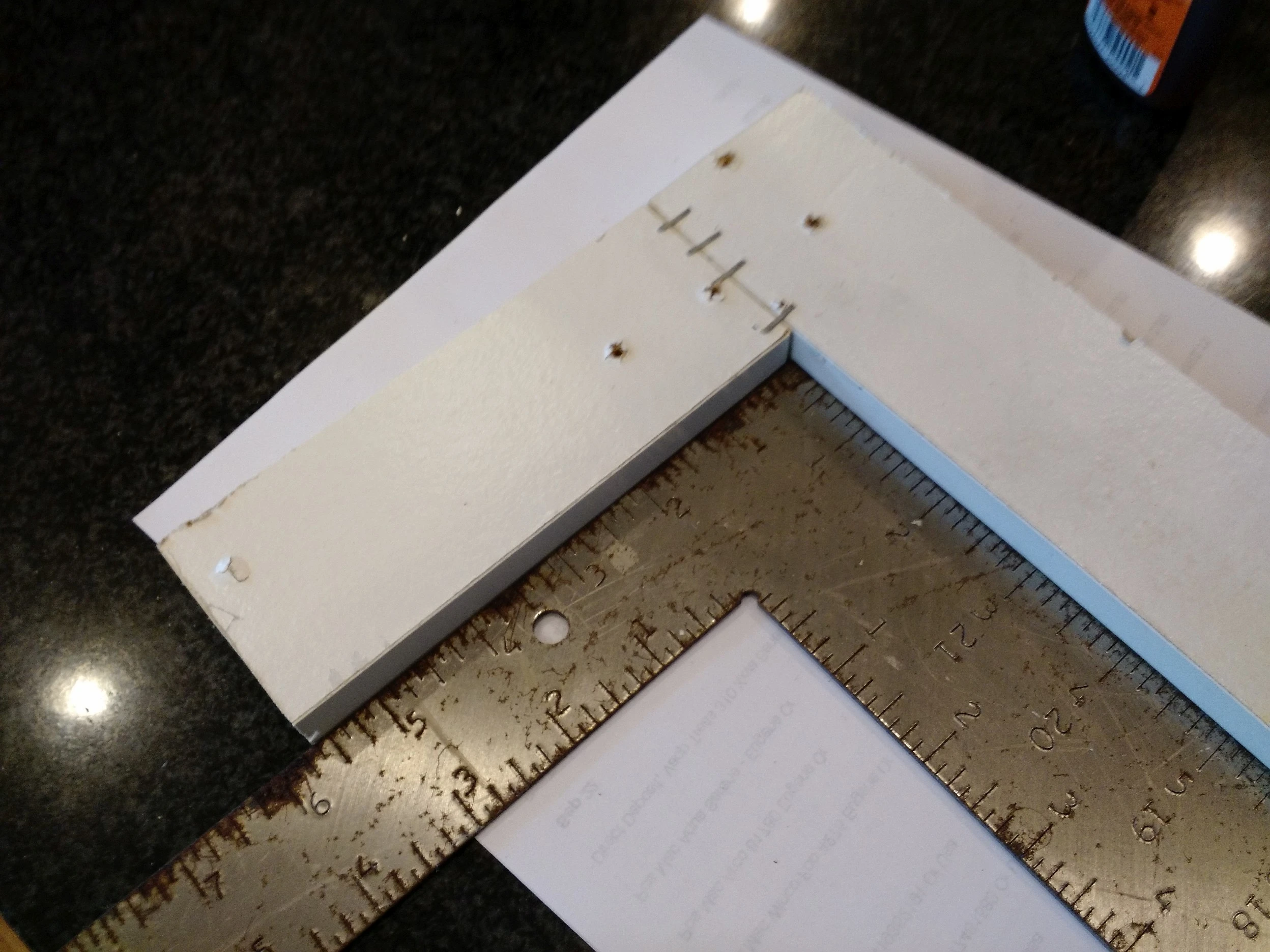

I used some scrap melamine (white laminate board) to make my guide and stops. I used these scraps because they have straight edges that square up.
In the diagram below, there are lines outside the perimeter of the lid. These lines are where you trim with scissors. The edges are 29mm to the lane to be routed, when lined up with the frame/rig. After trimming the sketch, I butt the edges up to the squared melamine boards and mark where the nail holes to secure the lid will go. I then drill the holes so that the nails will slide snuggly in when securing the lid. This will hold the lid squared up with the frame.

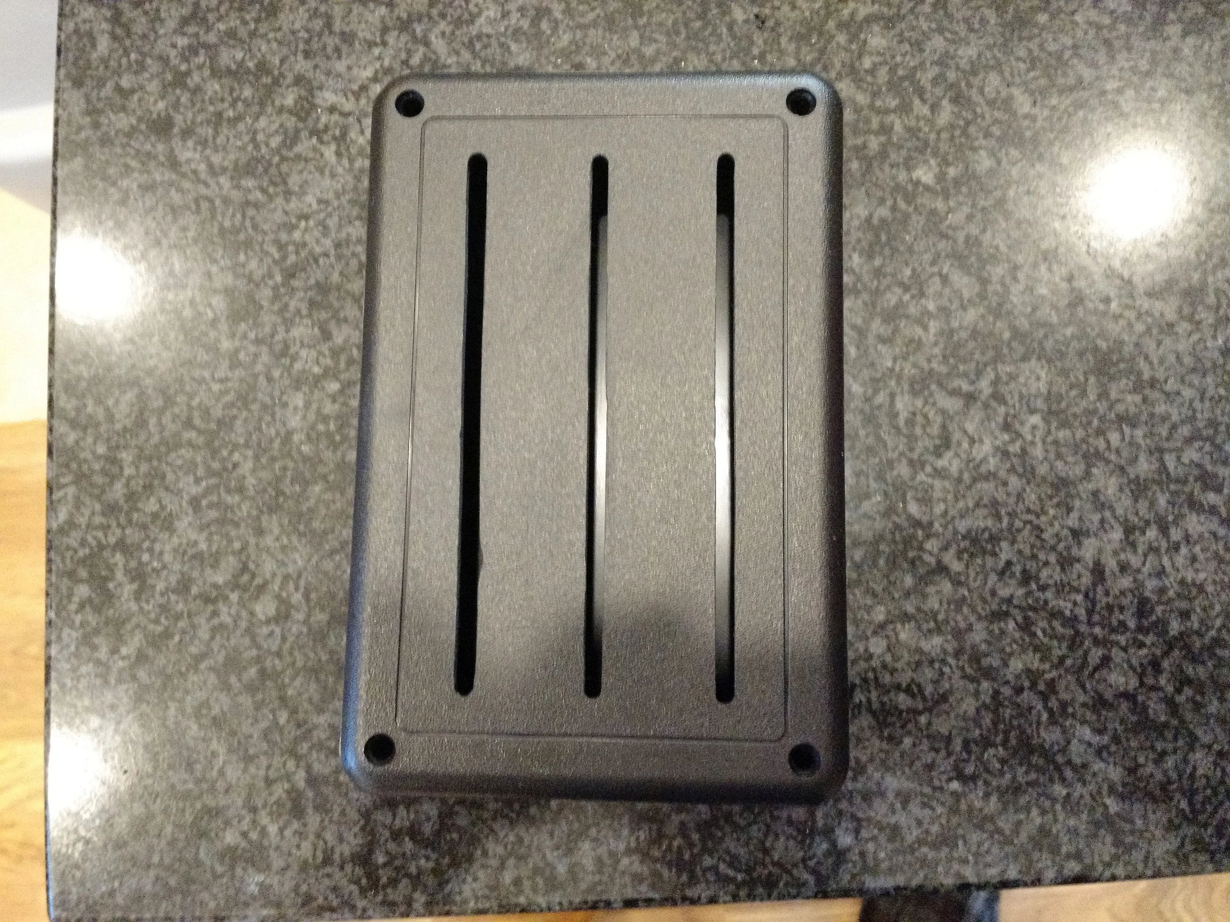

What I did was set my Dremel in the middle of the lane, with the router bit above the lid. I ran the dremel at about 10k, and lowered the bit to drill through the lid. After that, I guided the dremel to one side, and then the other, until the edge of the router attachment butted up to the left and right stops. Do this a few times to get a clean groove, then use some sandpaper to remove the fine stuff. After the first lane, spin the lid around and route the other outer lane. I then secured one more piece of scrap melamine to get the center routed (sorry, no pic). Even with all of this, I slipped and grooved a little bit outside one of the lanes. It's hard to tell because I blacked-out the aluminum surface of the sliders with electric tape. I may pick up a couple more boxes someday, and do it again...if I'm bored enough LOL. Actually, I might build a four-channel, touch sensitive version.

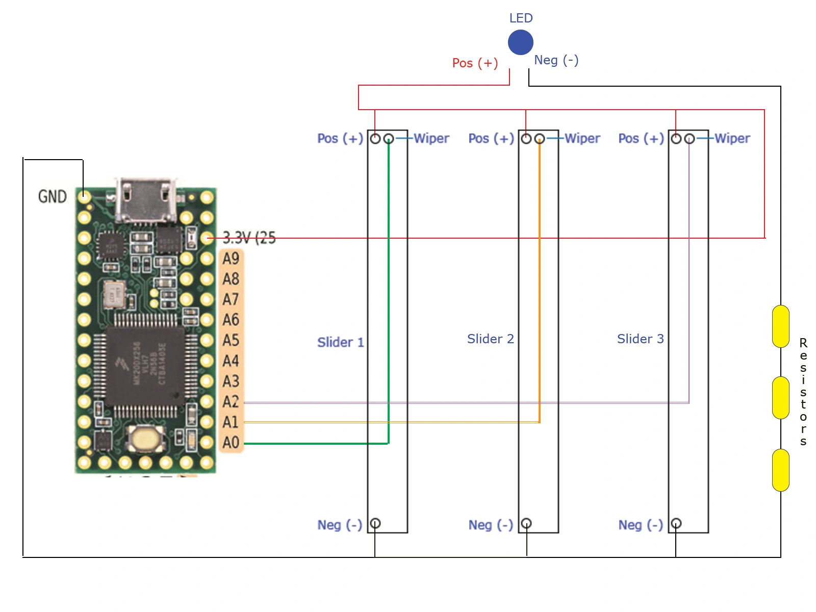

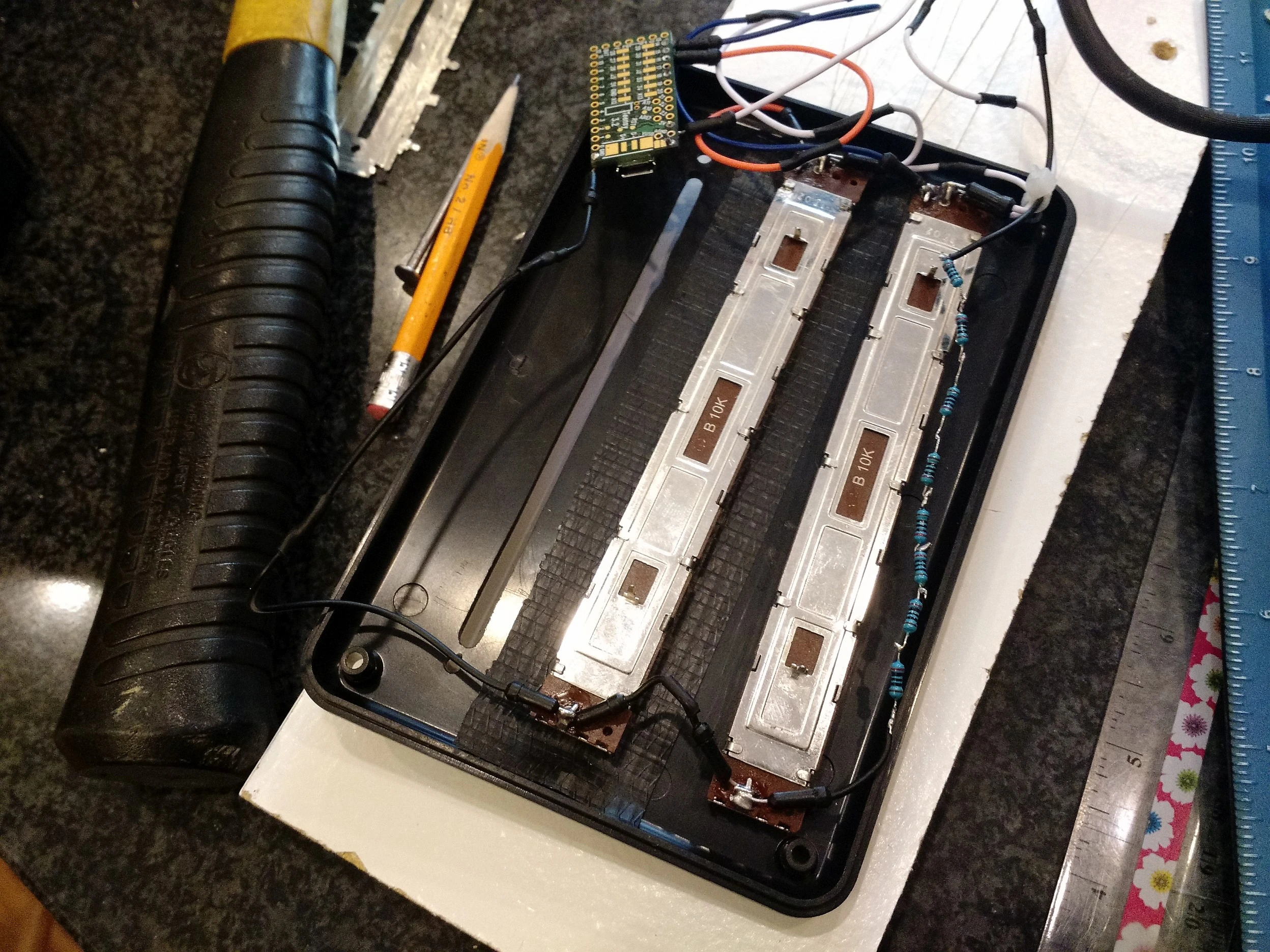

Then I wired everything up. Note the row of resistors on the ground wire, on the right side. The led is really bright at full power, and I just used some of the extra .25 watt resistors that came with the LEDs. This removes a couple watts and dims the LED nicely. I used a little Gorilla Glue to secure the row of resistors to the side of the case.
I'll post the wiring diagram below.

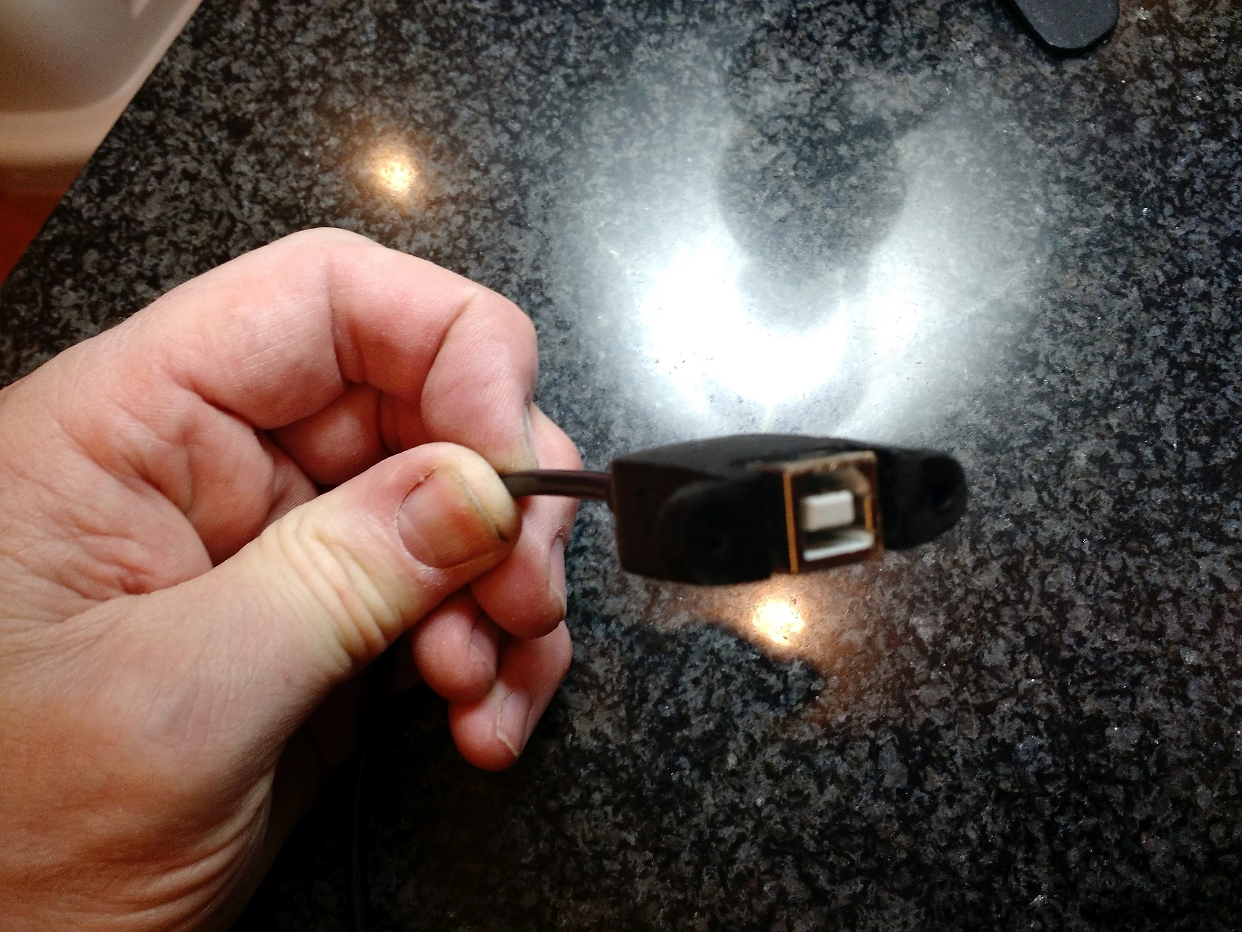

The box I got is fairly short, and I ended up having to shave down the USB jack to make it fit under the center slider and the mounted LED.

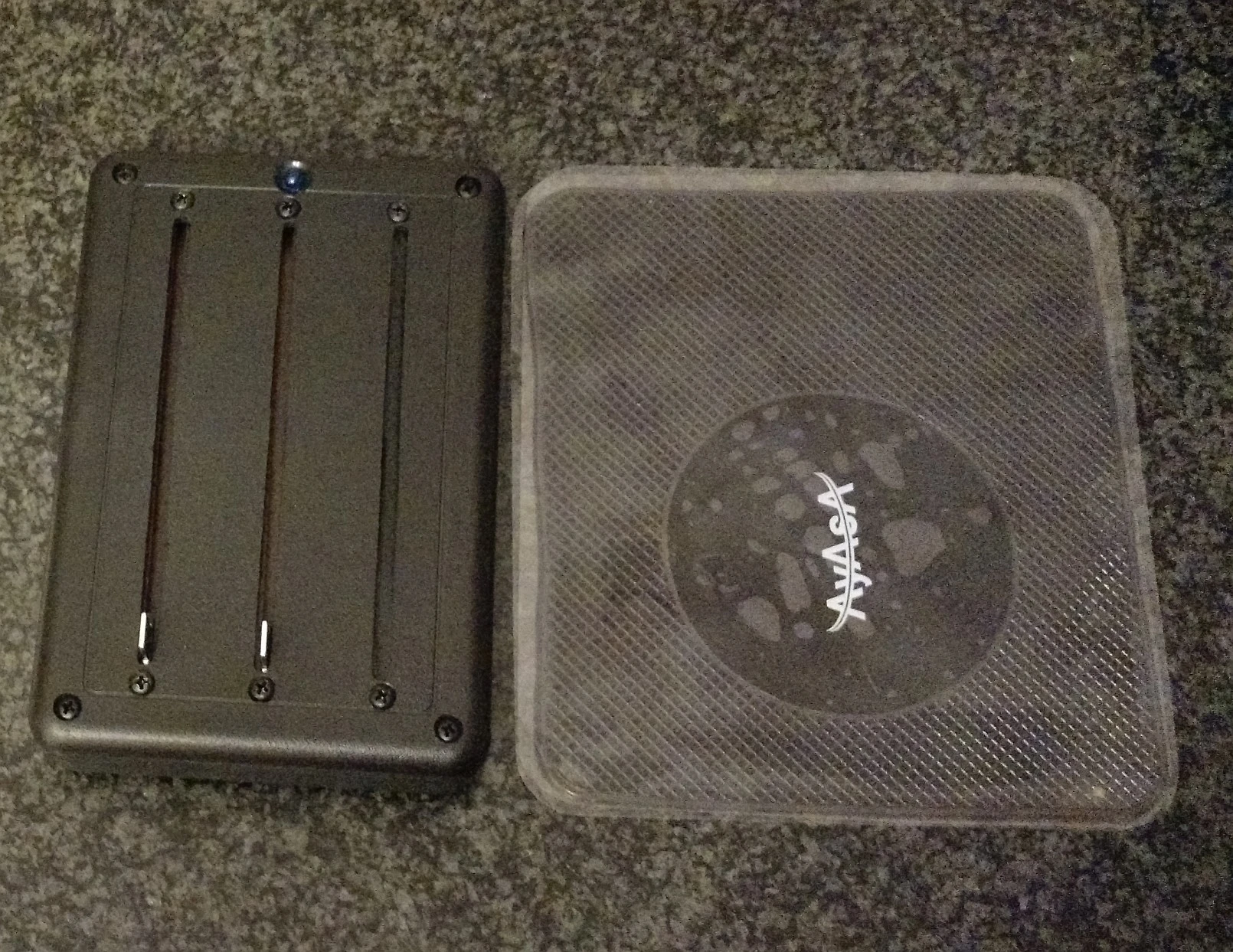

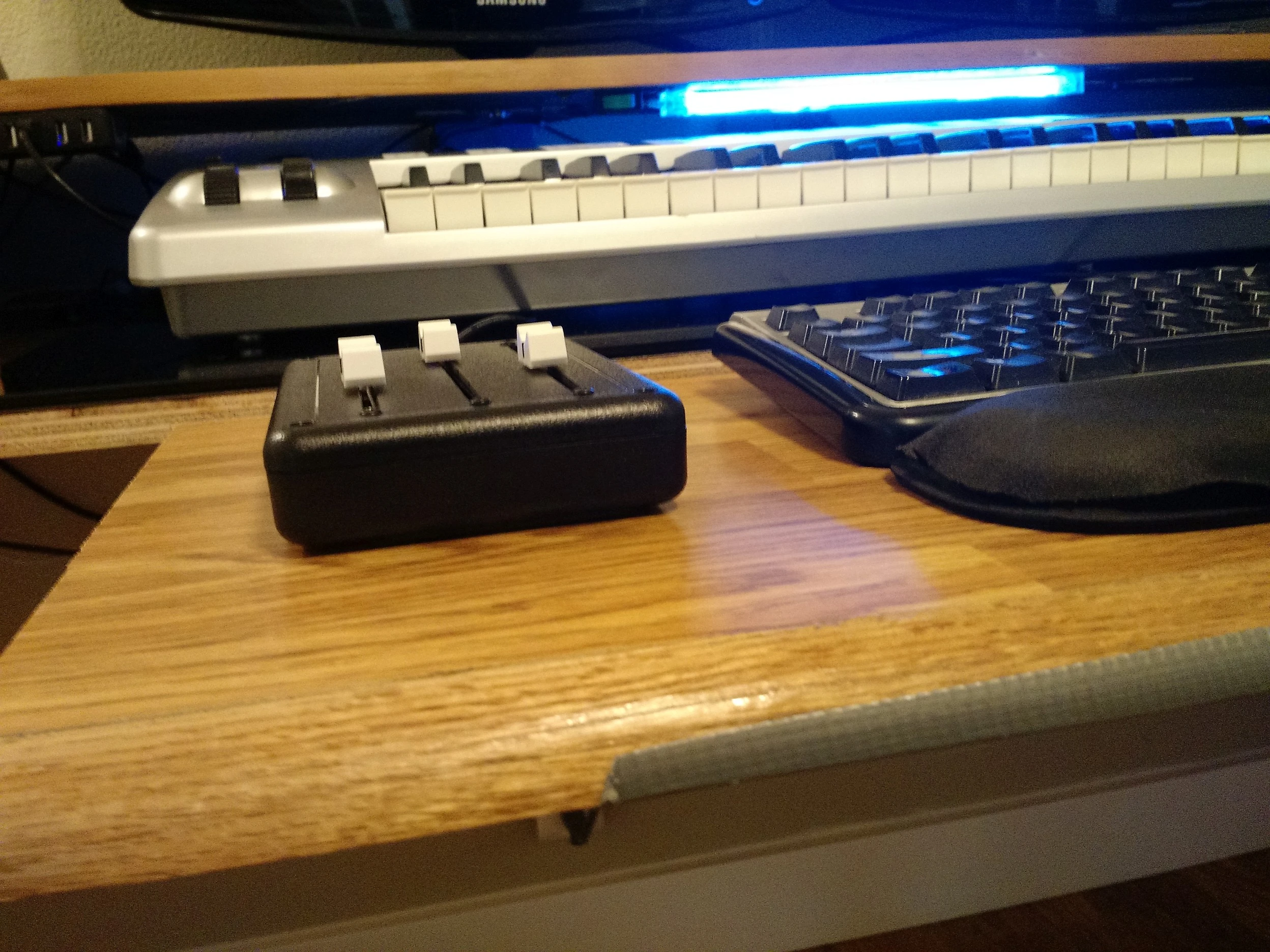

Instead of using rubber feet, which would raise the box substantially, I bought a car dash mat. It's really sticky, and once it's in place, it'll take all the pushing and pulling you can dish out. It's not going anywhere! I cut it down to size. Here's the dash mat I used.

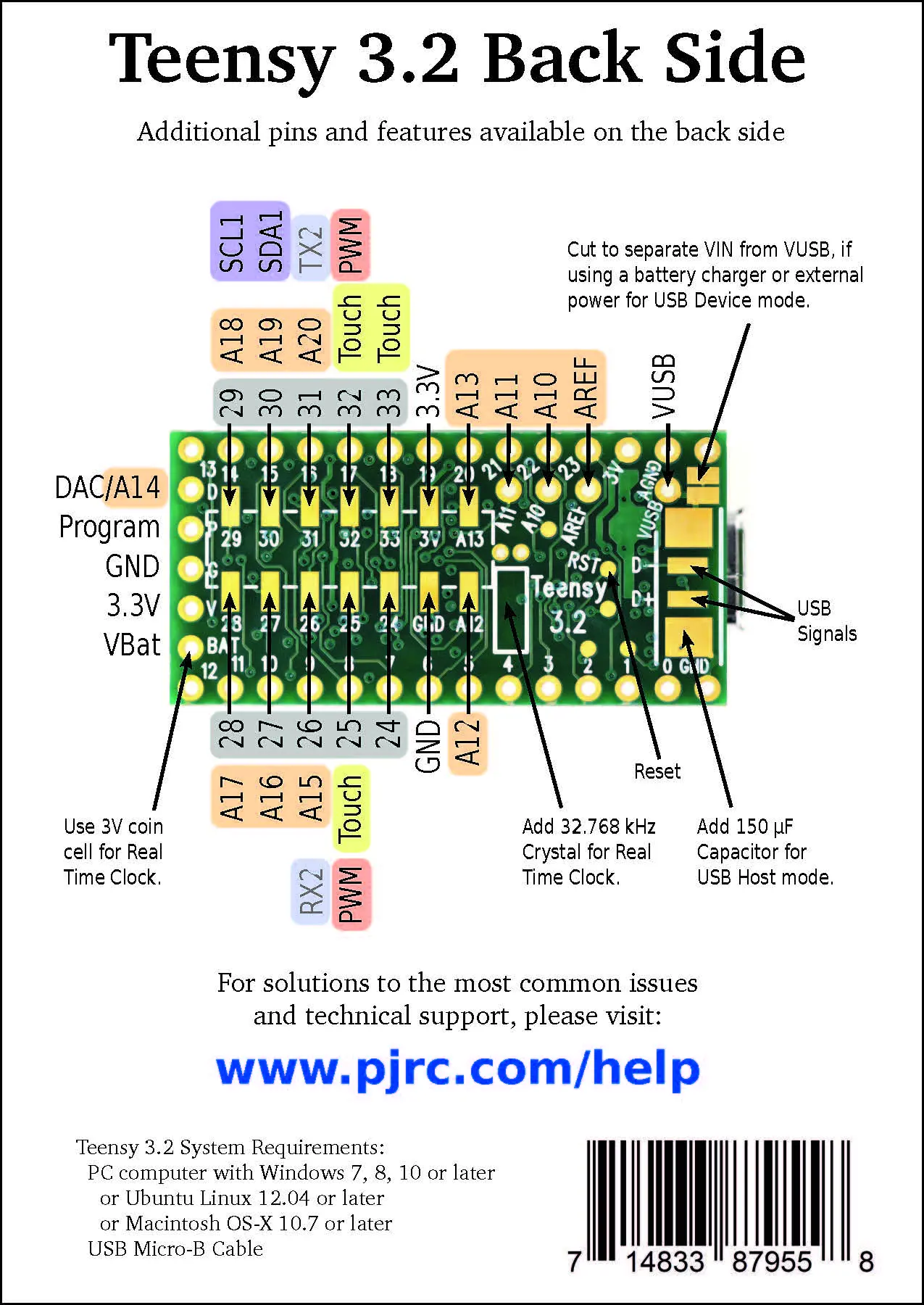

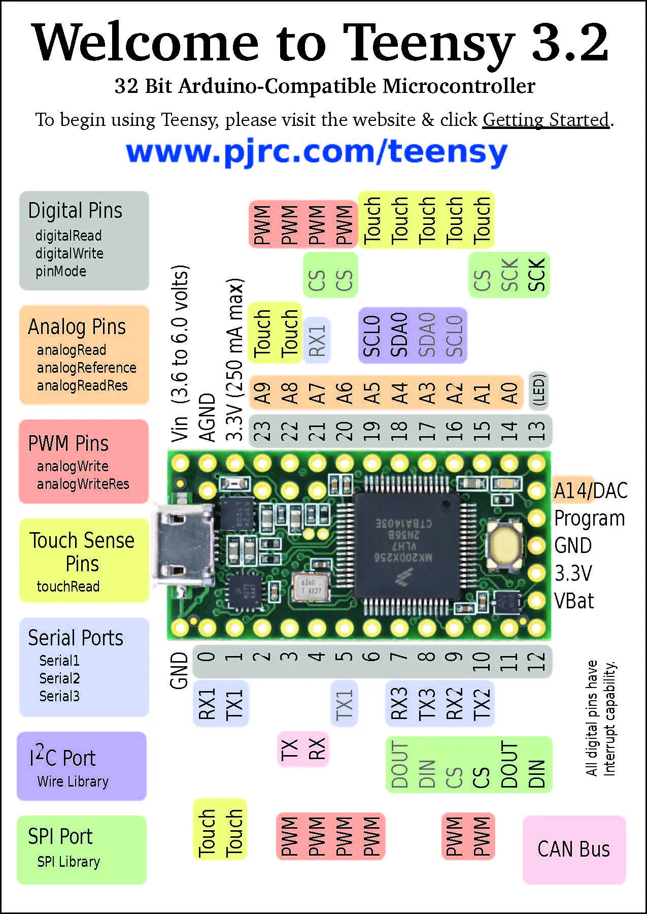

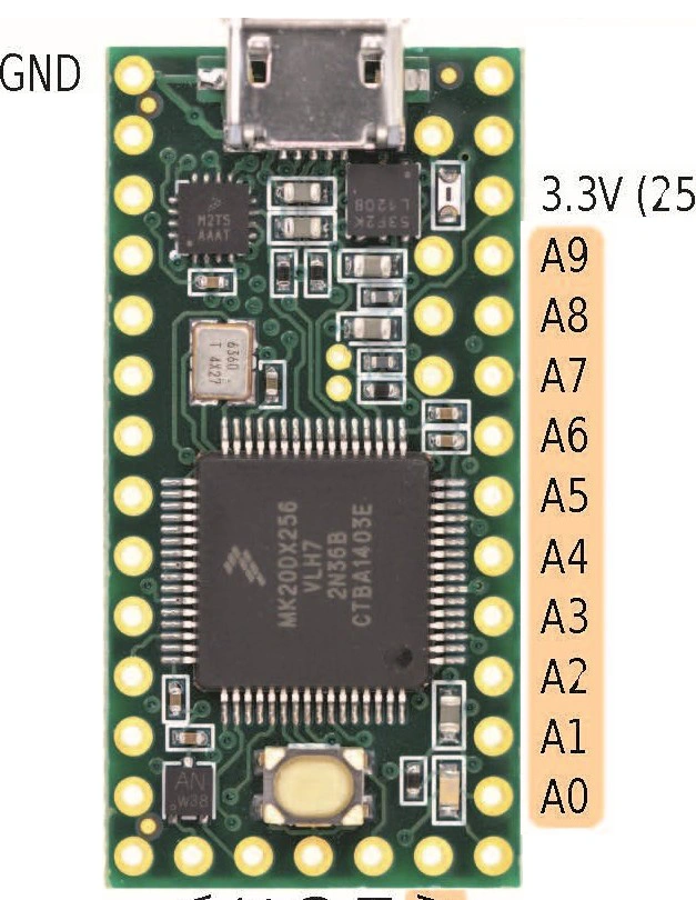

Here's the Teensy board diagram, and the pins. It comes with the board as well. I'll post my diagram, along with some explanations.
Here's my wiring diagram.
Be sure not to use the VIN (3.6 to 6.0 volts) (not shown here). This will cause the faders to max out at half the distance, because of doubling the voltage.

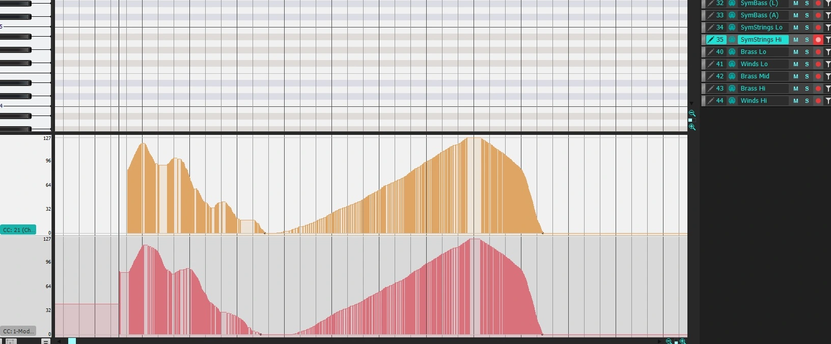

This is the detail I get with the faders. I was waiting for a replacement fader (the 3rd one), so I only have two CC's showing here.
Who's doubling what voltage?
Not seeing it in the schematic, there.
How does a fader "max out at half the distance"? There will always be voltage present, albeit small.
I'm not keeping up so well.
He's just saying be sure to use the pins marked in diagram in post #12, because there is another, higher voltage, pin someone could easily use by mistake. ;)
It's shown in post #10.
Enjoying this @jsbenson ^^. :)
Exactly. If you look at the original diagram, the higher voltage pinout is the top hole. Someone might see that and think, if 3 volts is good, more power must be better. Might be better for some applications, but not this one.
