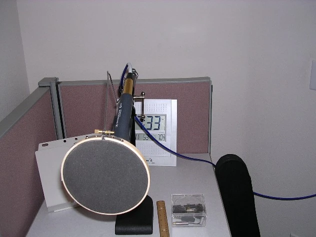

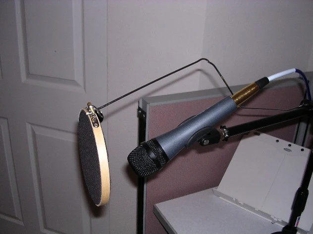

Hey Guitar Dave. I made my own out of cheap nylons and one of those needle point hoops (stitching hoop -someone help me I don't know what he heck is called). It works great. I attached it to the mic boom by buying a cheap metal hanger, and twisting it. I'm not too happy with the hanger part, but it works. I've been using it for almost a month, eliminated my plosive issues.
Here is a picture of my pop screen!
It's not too pretty, but it works! Oh! It took a total of 10 minutes to make. Well, if I count the trip to the store to buy the stuff, then it took about 1/2 a day (I got everything at Walmart).
That looks way better than I imagined from the description. Nice work.

Wow! Thanks! It's nice to get a compliment.
It literally (is that the right spelling?) took no brain cells to make, and the dexterity of a three toe sloth. Not hard to do at all.
The actual harderst part was going to Wal-Mart on a weekend. The total cost was $0.99 for the nylons, $1.65 for the hoop, and $2.95 for six wire hangers. I want to make a better arm or something to hang the pop screen from, but I've become lazy and I don't want it to take too long.
I thought of making an arm out of wood, but then that would be heavy, and I'd have to design it so that's adjustable, and that would take time and it would be bulky.
Anyway, thanks for the compliment. :)
