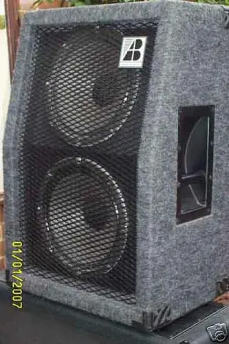

The best sounding quad I've ever struck was an old(er) Boogie 4x12 600watt, half closed, half open. Boogie later downgraded the speakers to a 300watt total and I think the design has been discontinued.
It's been my thought to build a pair of 2x12 cabs similar to what is in the pic (courtesy of ebay Aust.,) BUT to close the bottom and leave the top open.

wow that pic is pretty much exactly what I had in mind!! 2 of those for my stereo rig - it'll be awesome!
I'll cover it black, and spray the hardware UV green :D :D Things like corners, the rims (gaskets?) or the speakers and the handles uv green! would look sweet
Do it bro. I've built a LOT of my stuff. The fun is in the journey, not the destination.
Looks like the old ADA cabs. I've been considering building two like that myself as new store bought ones are an uncommon find these days but think having a pair is a really flexable combination.
1) Much easier to transport two of them to a gig than one 4x12
2) You can use just one at a time for smaller gigs
3) The ablity to break them apart in stereo with some distance in between is mad cool.
4) You can leave one at home and one at rehearsal.
5) One can be your moniter while the other points at the audience
I'm suprised they never caught on bigger than they did but I guess they were just more popular in the 80's when stereo rack units were more common.
