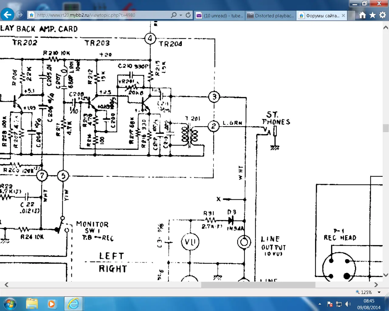

Found "a" schematic. C211 shows the idea.
BLLX! Can't be that if the schematic is right!
The headphone matching traff would only be a few 100Ohms and would cause distortion if the cap were short.
You will just have to get systematically diagnostically with it!
