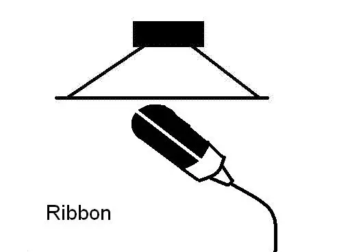

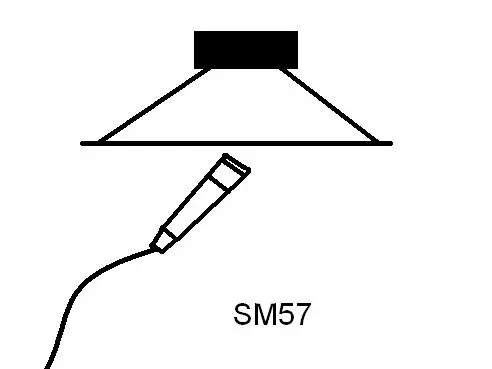

Here is how a lot of times I like to place my mics.
Playing with the degree of angle and distance to taste.
The length of the ribbon element is parallel with the cone of the speaker to pick up a wide range of the surface area (and sound) coming off the speaker.
The SM57 is much more focused at the surface area it's aimed at.
Some times I'll remove the grill if it's practical.
