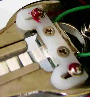

As a side bar - there are some minor variations in the ribbon motor structures in the various model. The Tape Op group buy ribbons I have (210-style) have ribbon tension adjustment screws separate from the ribbon clamps. This makes it much easier to adjust tension if needed. And there are some minor variations in the motor shock mount.
Hey Mike Is there any way you could post a pic of that ribbon tension adjuster?

Cool. I think the only ribbons that I have seen were the type that have only the clamps. On occasion, I have successfuly re tensioned these ribbons, but it is a tedious job
Ok Chance, here's your joe and a pic.
Notice how the nylon block is slotted to allow lateral movement while the ribbon clamp screws remain tight.
