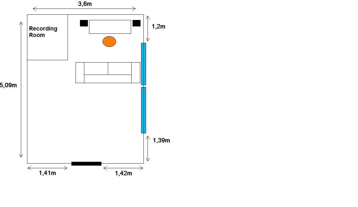

I have a room in the basement that I want to use as a home recording studio and I'm having trouble designing it!
I would like some space for mixing and some for recording vocals and acoustic guitar. I could set up a wall at the end of the room to separate the room, but then there would be under 1m of space.
What's the best way to design this room?
I have attached some pictures!

That room is too small to break into two rooms, so most here will advise you to plan on mixing and recording in the same room.
Put your mix area where you have it (without the barrier for the recording room) with speakers firing down the long length of your room, with your listening spot about 38% of the room length from the short wall. Speakers and listening position should form an equilateral triangle, with your speakers angled to follow the triangle. Keep monitors at least a couple feet or so away from back or side walls.
Add broadband absorbers in all four wall-wall corners, and at first reflections on the sides and ceiling over the mix area. Then adjust to taste from there, treating back wall and more of the side walls and ceiling as needed. Avoid large expanses of untreated reflective parallel surfaces (wall-floor, opposing walls, etc). Use rugs, heavy upholstered furniture, etc to help treat.
If you are serious about a good recording/mixing space, shoot your room with Room EQ Wizard and a measurement microphone thru your interface to help you get a good room response.
Check out room setup guides on gikacoustics.com and realtraps.com .
Well, I was going to offer something helpful, but the last 2 posts said it all. ;)

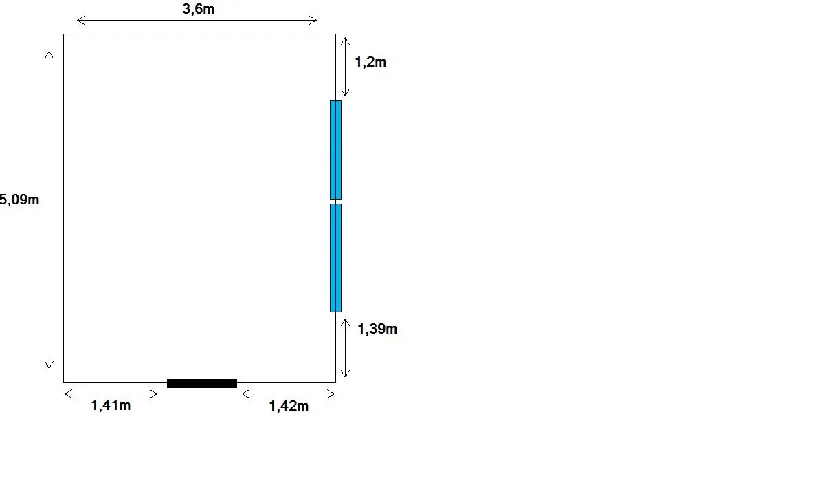

How high is your ceiling? Is it finished or open joists?
Cheers,
John

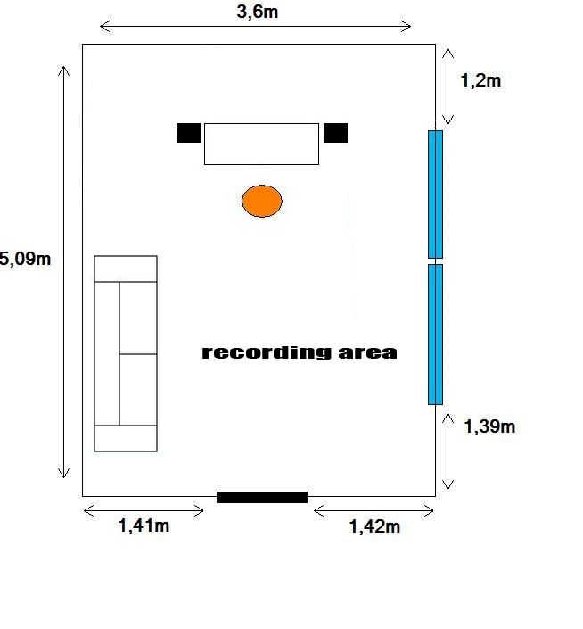

What if I really want a recording booth. What about this design? Do you think the mixing area will become to tight?

The mix area would seriously suffer, not to mention that it will be asymmetrical.
What do you need a booth for?? Drums? That is the only instrument that is difficult to record in the same room.
-- I guess I must write the paper; "The myth of the booth".
