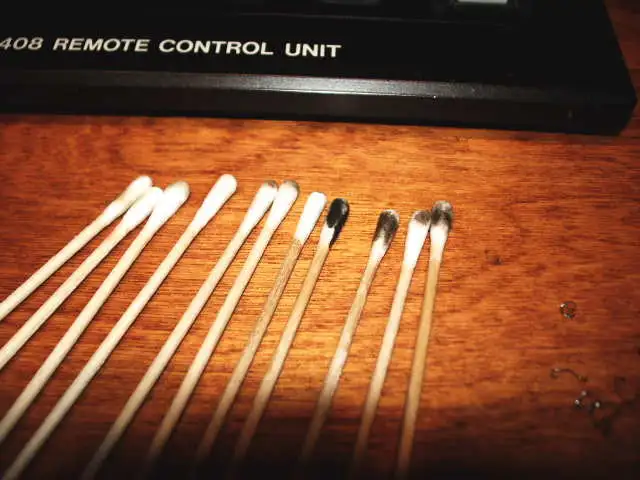

I have cleaned the heads and rubber rollers, I am always surprised to see so much black residue come off the rubber rollers. This must be the rollers themselves shedding? Also I found a lot of little spiral shiny metalic "thingies". They look like they are comprised of tape residue and metal. I have never seen these before, I suppose it is because I only found them on the (new) MS-16 were there is a level surface for them to collect. My other Tascams are all mounted upright so these things could fall to the floor.

Forgot the photos
VP

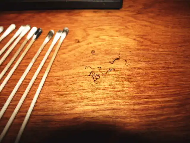

And I've done LOTS of cleaning on my reel to reels for 40 years and I have never seen anything like those curly ques before.
If they have metal in them then I have to think there's a problem there somewhere.
I don't find that normal at all.
All my Tascam manuals warn of this happening, I am trying to copy the page I just scanned. I cant seem to copy and paste it either. You will have to take my word for it for now.
I was looking at the curly things with a magnifying glass and it looks like tape residue with some fine metal dust stuck to it, I suppose it is normal wear from the tape lifters and such. If you look closely at all the metal surfaces you can clearly see that they are getting worn down, that metal has to go someplace.
