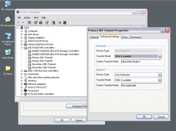

Do you have DMA enabled for the IDE channel that the CD/DVD drive is on?

the primary was alreayd set to that, but the secondary wasn't...so i changed it, and also messed a little more with the dma buffer on the maudio control pannel...and it rid a lot of it for the audio cd's....but it's the same on the dvd's.
