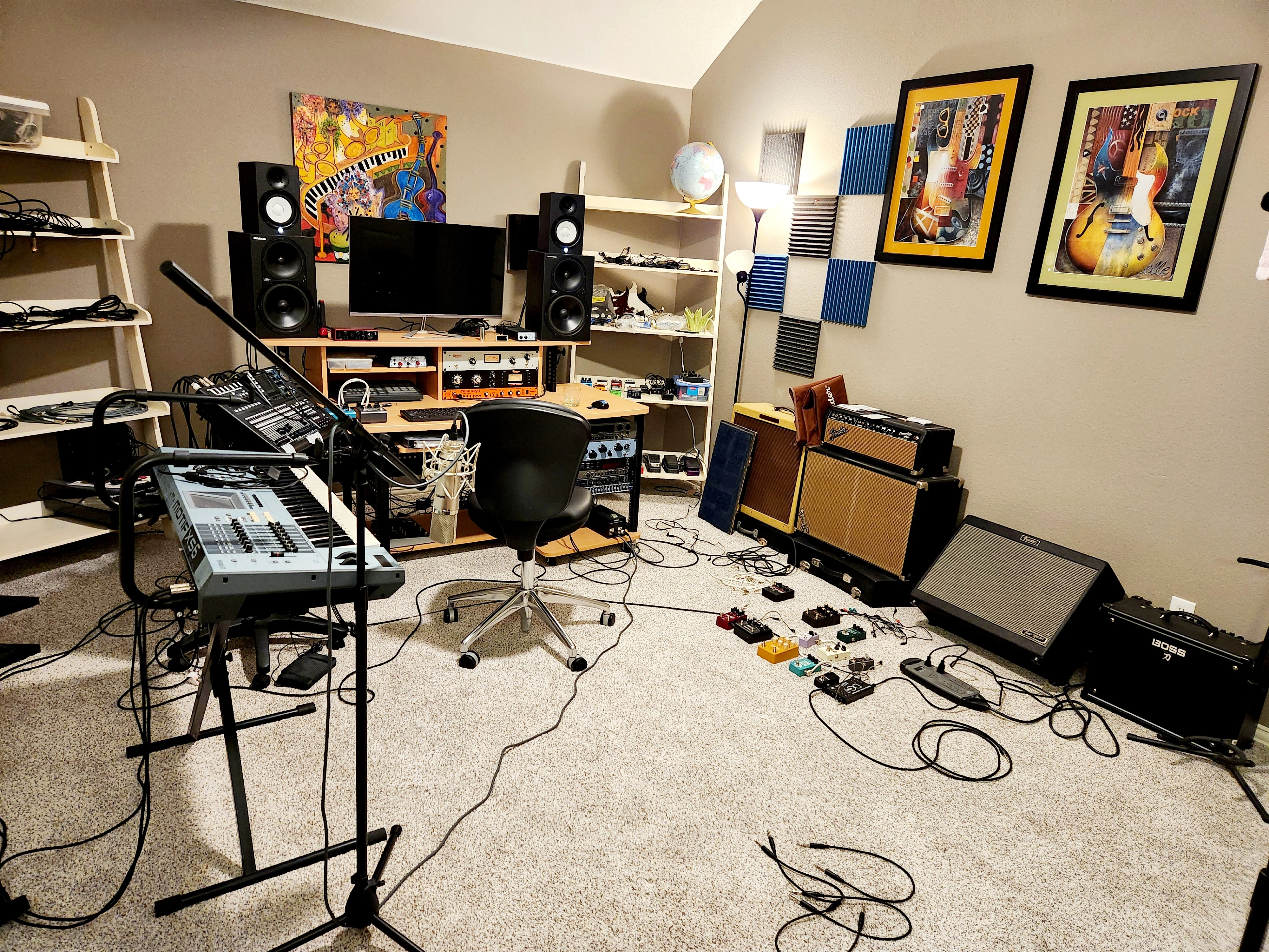

Nice picture ..:)
....is it Fanless or Silent Fan? Did you notice a reduction in noise?
Great thread, Rich saying the Mini PC is a "laptop without a screen and keyboard" makes it seem less strange buying a little black box.
I think a MiniPC is what Im looking for too.
USB connections will be the thing, what's that look like?
