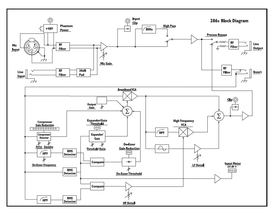

Mic preamp with processing (channel strip). I have one and I seldom use it. I actually set it up with a Behringer mixer this morning to see if I could get some 'hiss'. I don't think the OP mentioned a mic connected to his, but I connected up an EV ND967 dynamic I had handy which has a fairly hot output. TRS to TRS cable from DBX to the line in on the Berry mixer.
If the gain on the DBX is set for the level meter to just about hit '0' on the LED meter, the output of the DBX hitting the mixer is too hot to adjust with the mixer gain and would clip occasionally (the mixer I used doesn't have a pad). Interestingly the DBX Output gain control only affects the output when the processing is engaged, thus the only way I had to lower what was hitting the mixer was by lowering the DBX's input gain which I have no problem with. I don't see if the OP had the processing engaged or not, but assume he may have as he was using the output gain control to control what was going to the mixer. With processing engaged it is possible to introduce hiss if not careful with a couple of the settings and the manual does make note of this.
With either no processing or with it engaged and minimal processing I did hear some faint hiss, but not an objectionable amount.
To note, I don't use this DBX with an SM7b or RE20 without an extra boost from a FetHead. Cranking the gain for an SM7b alone does get hissy with the DBX preamps.

If, as you say Mark the DBX unit needs a certain level of gain to reach its optimum operating level that puts the OP in a bit of a bind. Compressors and other dynamic devices need to run at a certain level otherwise there is little or no effect.
You found that optimum level too hot for the Berry mixer and if that is the OP's problem he needs an in line attenuator and of around 10dB I would guess. Two problems, the attenuators need to be at line impedance, around 10k/10k balanced and fitted at the mixer end. Such widgets are very hard to find, almost everything is "600 Ohms"!
