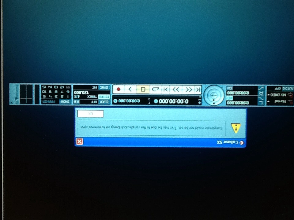

Not sure if this is relevant, but when opening Cubase, I get the error message "Samplerate could not be set. This could be due to the sample clock being set to an external sync". I have checked and the sample rate IS set to internal.

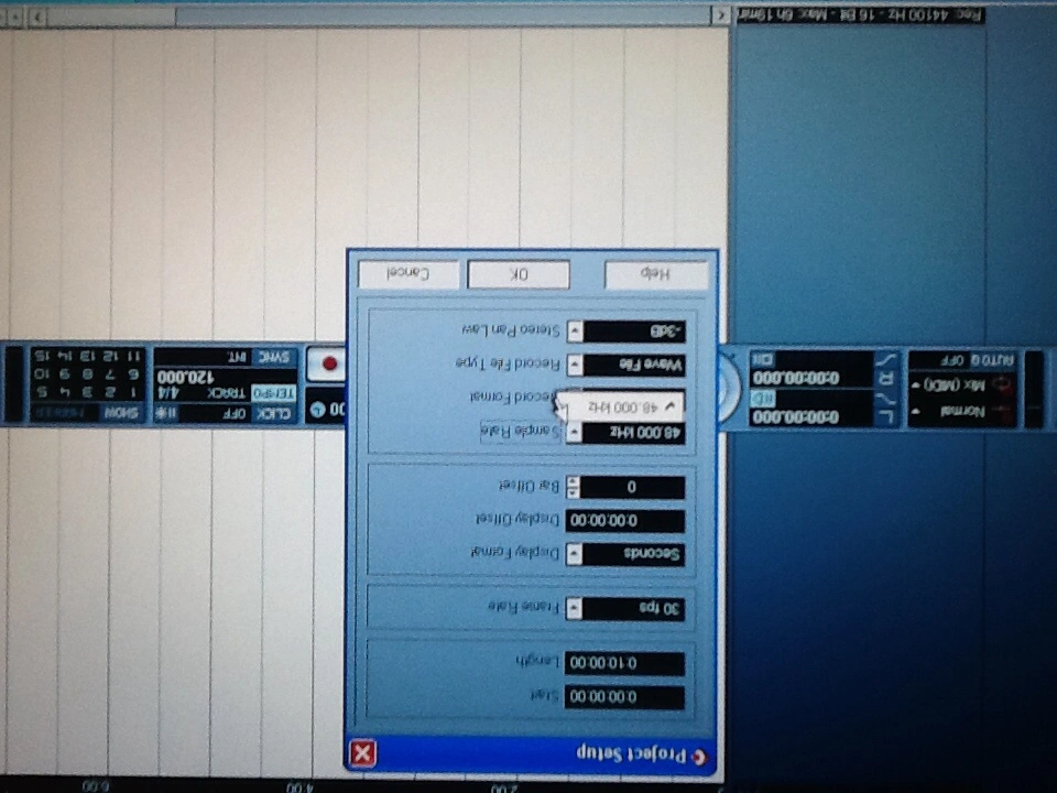

And to demonstrate that I only have 48khz as an option...

Still, no mention of soundcard (upside down or not). It sounds like you don't have an interface and you are trying to record at sample rate your internal is not capable of....
I can't imagine a laptop having a 96k capable soundcard natively EVER... but I could be wrong.:D
Sounds like you're trying to use the built-in soundcard.
Those have 40cents worth of chips made for cheap beeps, boops and light gaming.
Get a true asio interface ($50 and up) and ignore the built-in POS.
Also, purchase of even a cheap interface will come with a more recent DAW than the SX you have.
