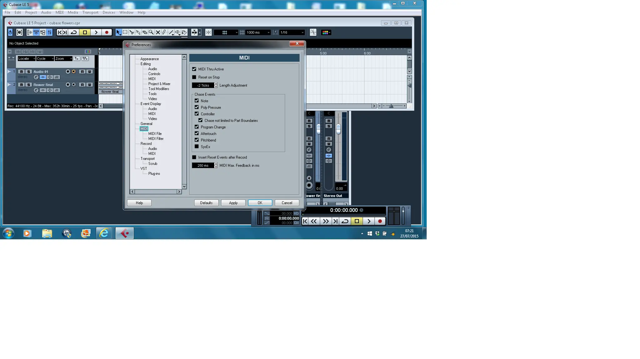

Have you got "MIDI Thru Active " ticked?
Go>File>Preferences and refer to the attachment.
