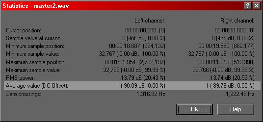

My software (Sound Forge 6) reports that Master #2 has an itsy-bitsy, teeney-weeney DC offset to it. Only on the order of about -90dBFS, so it's nothing I'd worry about too much, and I'm sure it has virtually zero effect on the sonic outcome. I only bring it up out of curiosity: does this indicate that the students had different gear to work with?

It's interesting to me that it's around -90. There was a software bug reported on some of the forums regarding Waveburner dropping a bit when used in certain ways. If that bit was stuck on instead of dropped, hmmm...
Yep, one bit is what SF reported. Here is the actual display (with the key line highlighted). This is the only one of the three to report anything greater than 0[-inf dB]:
