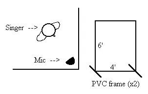

hm... I don't have a good idea of what type of shape you're talking about... could you explain it better somehow? (get out photoshop or windows paint!) or use ascii hehe.
Hopefully, this will work:
Looks like Harvey is talking about building a free-standing "corner" but use pvc pipe instead of wood. Should work well.

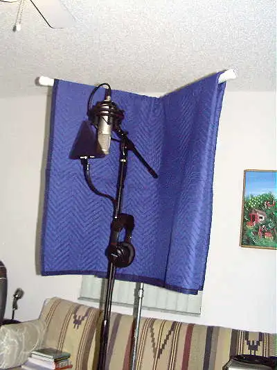

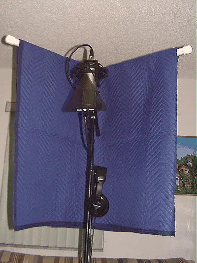

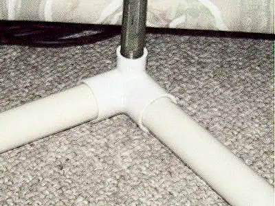

...here's a few pics of a free-standing corner baffle that I built from about $30 worth of items all purchased from Home Depot...using the steel pipes as the upright gave it more ballast and ridgidity to help support the blanket (these moving blankets are surprisingly heavy which is why they make great baffles!)...also, by using 2-3' sections of pipe, you can set it up with only one 3' section for sitting/guitar miking, and two sections for a taller/standing vocal booth effect...it breaks down easily for storage, and works quite effectively in a situation where you cannot do more permanant sound treatment...it's constructed from the following items:
2- PVC 3-way corner joints (junction 1/2" threaded to 2-1" PVC pipe outlets) see pic #28
2- 1/2" steel pipe X 36" with threaded ends (to make the 6' upright)
1- 1/2" steel coupler joint (to join the 2 pipes together)
2- 1" X 3' PVC Pipe (for the top supports for blanket)
2- 1" X 4' PVC Pipe (for the legs to stabilize upright)
4- 1" PVC Cap Ends
1- Heavy Duty Moving Blanket
...takes about 10 minutes to assemble...very similar to what Harvey suggested, but all in one unit...

...actually, I have used the "moving blanket draped over an extra boom mic stand" method I described above ("T"-formation to support the blanket) to create the section you recommend...so the additional cost is only $14. for the extra blanket (since I have extra boom stands hanging around)...it does assist to isolate the vocalist quite a bit...I must say, that the moving blankets are a MAJOR improvement in an untreated room, at minimal expense...on top of that, these "baffles" can be setup and broken down for storage in minutes...well worth the $30-45. invested...
