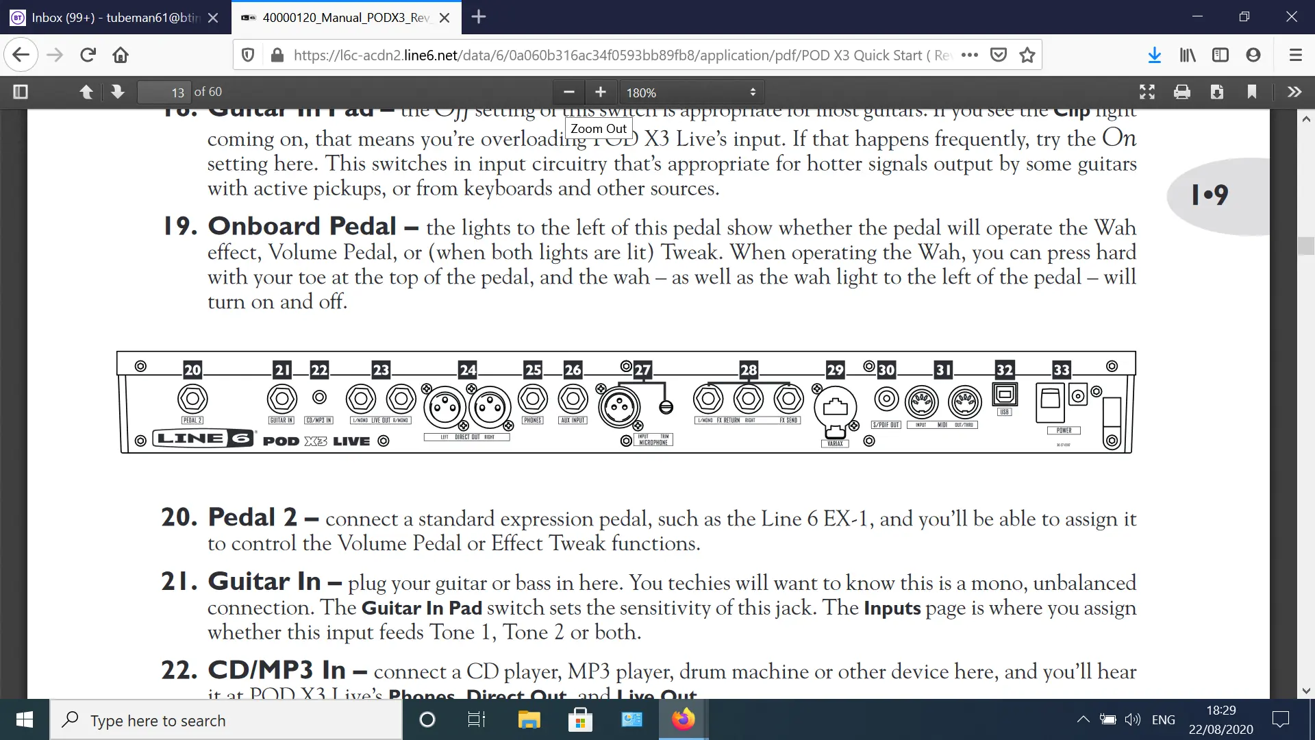

Right chap. It would seem you have never used an interface, I have never used a Pod 6 and the rear of the Pod is a bit of a nightmare!
Does yours look like the attached? If so, read on...
The pod connects to the PC with a USB 'A to B' cable, probably got one with it but they are a $ or two almost anywhere.
I strongly suggest you read the manual for the pod and if you don't have it, download it. R.E.A.D. The section devoted to "connection to a computer" and download any drivers they suggest you need. (the manual suggests you should have, or be able to download some recording software but if you don't have that, download "Audacity" for now)
Plug guitar in and you should get the meters moving on the computer software. You can listen to the PC output on headphones but there are both XLR and jack outputs to drive external active monitor speakers or a hi fi amp if you have such a rig handy (but go easy on dad's speakers with distorted axe).
I am sorry I cannot be of more help but as I say, I know jack about the Line 6 save what I can glean from the handbook. Rest assured though that you can 'plug about' and try things with impunity, you won't cause smoke. Keep the cans round your neck though, i.e. 'off ears' while you experiment because you could get very loud bursts of guitar or feedback.

Yes the diagram is the same as mine!
I will be having a look at the line 6 manual to see how to connect it to a PC.
