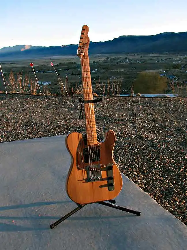

I built this one last year for $0 outlay, from scrap wood and parts from a defunct copy machine. It has active electronics, bridge and neck inductive pickups, and piezo pickups under the bridge. There are the requisite volume and tone controls, and a four way switch to individual pickups and all three summed.
It was my first scratch build (I'd built a Strat kit a few weeks earlier,) and used a few common power tools - table saw, small router, jigsaw, belt sander, dremel tool, bench drill press, stick welder, soldering iron, and the usual hand tools.
I had some of the stuff lying around - screws, switches, knobs, jack, pots, a FET, 9v battery and guitar strings, a hard drive, and part of a rattle can of polyurethane, but everything else was scrap.
So with some ingenuity and lots of tedious work, you can build a guitar on the cheap - go for it!

I built this one last year for $0 outlay, from scrap wood and parts from a defunct copy machine...
Looks real nice. :)
Musicians pick up a vibe from instruments, and that one wreaks that it sounds good. Looks like it wouldn't be stupid bright. I'm not big on trebly "new" sounding instruments.
What was from the copy machine?

Nice work, what's the go with those string trees though?

Copy machine parts? Please elucidate.
Steel plate for bridge, neck plate, control cover, jack plate.
Roller shafts for truss rod, tuners, saddles.
Shaft bushings for strap buttons.
Door magnets, solenoid wire, PC board, roller shaft for pickups.
PC board, wire harness, transistors, caps and resistors for electronics.
I built this for the MIMF $100 telecaster challenge (my challenge was to do it for free.) The thread is off that site, but if anyone's interested I could post an abbreviated thread in the DIY forum here (to avoid hijacking this thread) with pics, showing how it was built.
They actually serve a dual purpose - the major one was for fine tuners, as the tuners are just tuning pins made from steel shafts, and I thought I would need fine tuning control. As it turns out, I can tune it OK with just the tuning pins.

Since I'm not an electric guitar player, I really don't know how it stacks up with a real tele. However, I think the piezo pickup would qualify for "stupid bright." :)

A close up of the tuners and a description of the pickups would be of interest to the modders here. Nice work crazydoc..

You wound your own pickups? That's really impressive!
