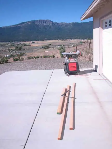

The basic materials were wood scavenged from cabinet shop cutoffs I'd gathered on my work commute, and an old copy machine given to me by a nephew.
Here's the wood - two pieces of alder on the right, and lyptus on the left (enough for four necks eventually.)

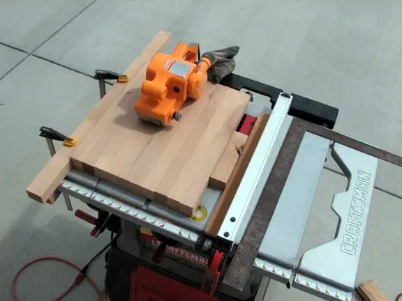

Sanded to thickness and flatness. (I found the belt sander to be one of my most useful tools.)

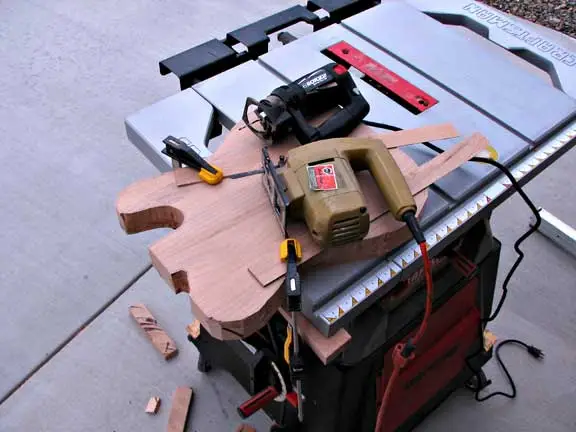

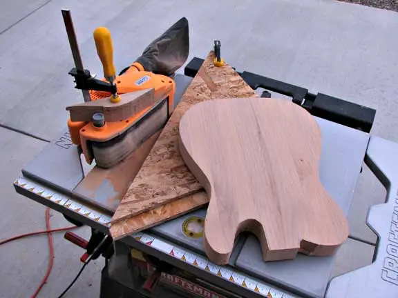

Cutting out the body was a huge PITA. The 30 year old jigsaw wore out, so I had to use the table saw, a rotozip tool, and rasp the do it.

More shaping/sanding.

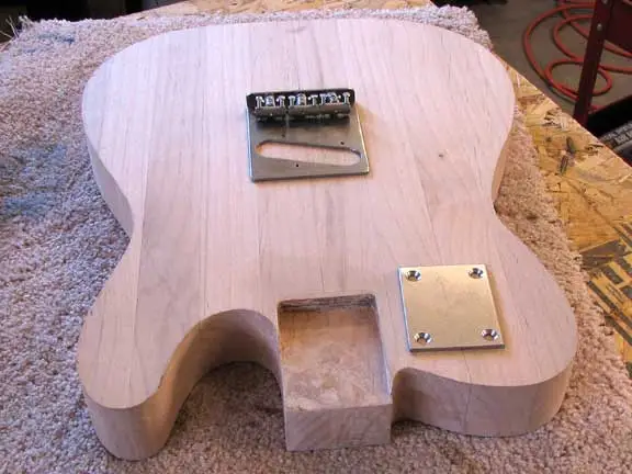

Neck pocket. This pic and subsequent ones were taken later, after the neck and hardware had been made.

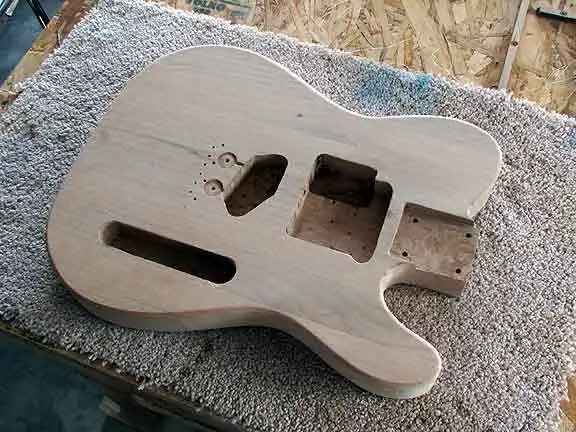

The body with all cavities drilled/routed, edges rounded, and ready for finishing.

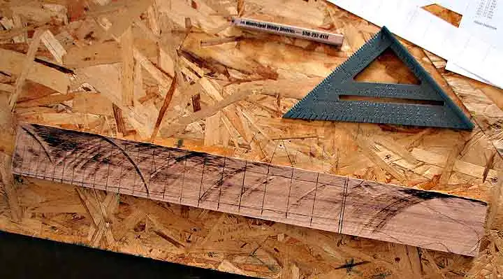

On to the neck. I ripped a slab off the lyptus board. I downloaded a neck and fret template and traced it out, making sure I'd printed it to the correct 25 1/2" scale length.

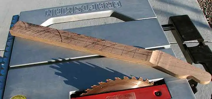

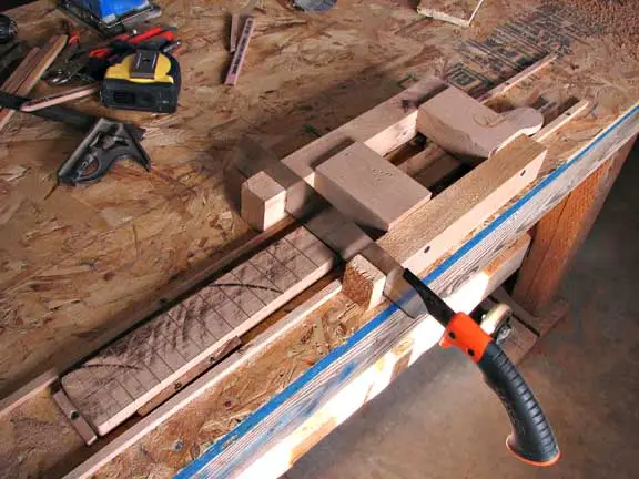

I cut it out with table saw, rotozip, and belt sander. I made a jig (basically a sliding miter box) to cut the fret slots.

Rough cut and shaped neck.

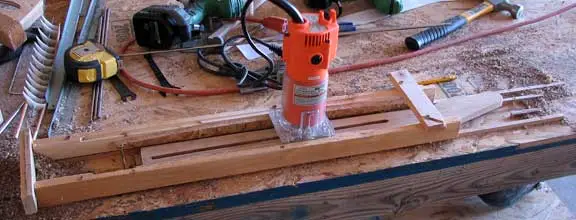

I made another jig to cut the truss rod slot. The truss rod has to be bowed slightly in the neck to work properly, so the slot has to have a curved bottom.
