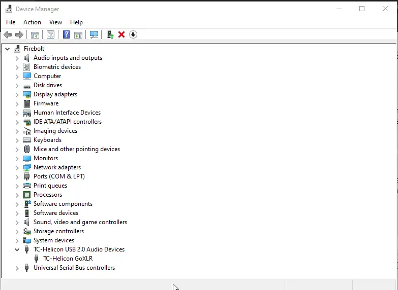

I doubt it's damaged - try redownloading the software. Digits are being dropped and replaced by one sample noise - computers often have this kind of strange behaviour. I assume you computer sees the device as one or more USB inputs? Drivers are the obvious thing to try if there are drivers. What does windows show it using in device manager?

I will try redownloading the software for the GoXLR. Someone in the TC Helicon Discord server (manufacturer of the GoXLR) suggested getting a ground loop isolator since it fixed the issue for them.

Did they suggest it because you mentioned crackles? Your issue is clicks - and if they're created digitally, then it's not a ground loop.
You now need to be methodical. Do you have another computer you can install it on? This will rule out the computer as the cause, and suggest it's the device, or it will point to the computer. I would be very surprised if it turns out to be a real fault - but if you rule out the computer that only leaves the GoXLR doesn't it?
