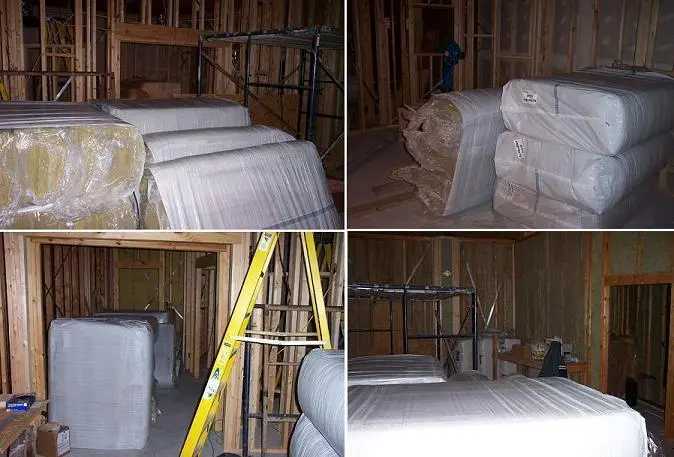

2100 sq. ft rockwool.

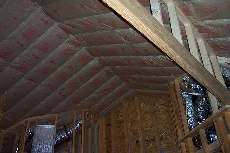

R30 insulation in the ceiling. I'm more concerned with R value in the small attic space than anything else

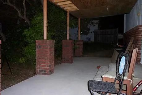

Finillay got a mason to do the columns on the patio.

The columns are nice... I like them a lot.
Brickwork over cement, cinderblock, steel, or wood?

frederic said:
You've come a long way... a loooooooooooooong way.
Well, the wood is the structural element that holds up the patio cover. They of course go all the way down to the patio foundation, and they rest on post caps.
The bricks are then set in place around the posts. I'm going to clad the posts in 1x6's, just to make them appear beefier.

I was hoping to be sheetrocking by now, but the rockwool took 3 weeks to get in, instead of the 5 days I was told it would take.
Even though my studio is simple and tiny compared to yours, I had delays like that as well. Late starts, engineering on the fly, home depot not have a single straight 2x4, etc.

That is a decent amount of rock wool... Are you going to fit the electrical soon?
The electrical is done.
Well... the rough-in is.
