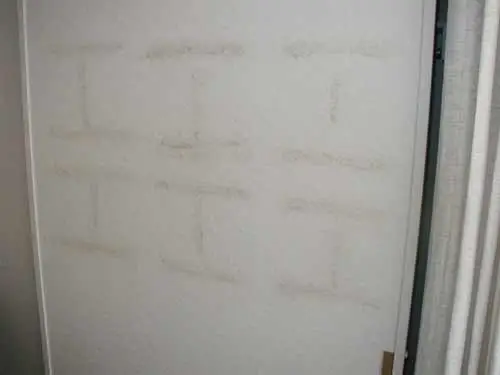

The thing that takes off 3M spray adhesive with Auralex residue is laquer thinner. You can find it at paint supply and hardware stores.
Cuts it like butter but remember to wear a vapor respirator or say bye bye to your brain.
Here's my two closet doors for a before and after, 20 min elapsed.

Or rather, after and before..whatever.
