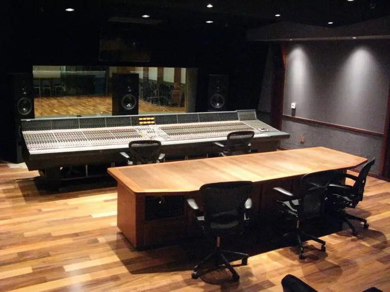

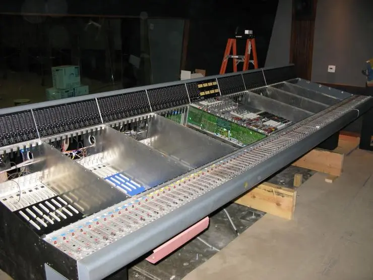

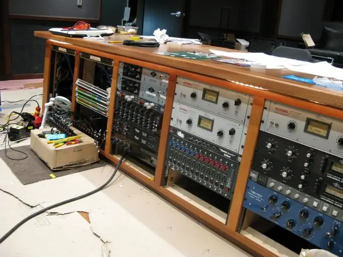

Gaaaaahhh...plywood on the console with the meterbridge uncovered...makes my chest hurt
Me too. Fortunately, the Neve channel/master section buckets were completely empty. They went completely through this beautiful console to re-commission it. Take a gander at the credenza too.:eek: Talk about pro? This is as Pro as it gets. Absolutely stunning. If you can stand a dose of reality checks, look at the whole build here.:eek: Unfreakingbelievable. Who says big studios are a thing of the past. But it sure takes some DEEP pockets:eek::p
