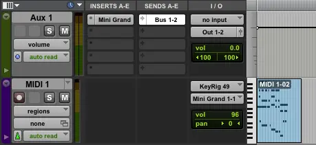

Hi, I've just joined and have an midi issues. I would be most grateful for any advice.
I'm using Protools LE 8 and an m-audio keyrig 49. The keyrig is connected and I can hear and record midi. My problem is that I can't convert the midi to audio. I have looked up several tutorials but the issue seems to be that on the midi track on the edit window, the insert/send options are not available.
Also on the l /O options I can only choose keyrig> (and then all channels or channels 1-16) & below that >none / or the synth that I am using; in this case mini grand.
Picture of the screen shot is attached.
I am sure it's simple, but I cannot figure out what I'm doing wrong. Any tips would be gratefully accepted!

I seem to have solved it, although it's nothing like any of the tutorials I watched on youtube.
I did the following:
-added a stereo audio track
-on the aux track I set bus 1-2 as a send
-on the audio track I set the input to bus 1-2
I was then able to record the midi into audio.
you also need to set the output on the aux channel to bus 1-2.
