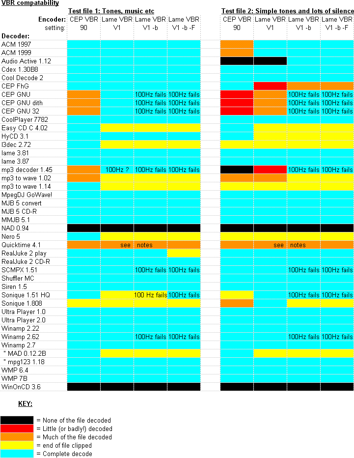

While most players can "handle" VBR encoded MP3 files...it appears many of them have various problems cleanly decoding VBR files....so while it may sound great with your encoder and your player...there can be marginal results on a multitude of other players...and how the heck can you know which types of players your audience is using?
I can see the guy who is just focused on ripping music for his own use...he will find the best encoder/player that works for his purpose, and he's happy.
But when you are a musician who is trying to get your music out there...I'm not sure I would want to chance VBR files when the CBR files will play back without a hitch on all players...and yeah, OK...you just use a slightly higher CBR and you will sound as good as the lower rate VBRs.
Here's a test chart for consideration:
http://mp3decoders.mp3-tech.org/vbr.html
yeah, i remember back in 2000 having issues with vbr mp3s, but that was almost 10 years ago. Most of the software on this list you can't really find anymore.
Then again, anyone using a player in 2009 that doesn't decode vbr mp3s correctly is probably the same person with the dialup connection.
