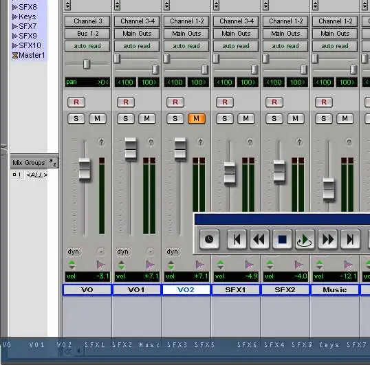

This SoftLCD thing sounds cool....
"New! SoftLCD displays 24 channels of data sent by your DAW app on your computer monitor just like a giant hardware scribble strip. "

It's not. I don't even bother with it. It doesn't show me anything different than Pro Tools does. Below is a quick screen shot of it. They don't have track numbers next to the names, I can barely read the font, they don't change colors or highlight when you select the channels, and you have to remember to start the SoftLCD before you start program otherwise it won't recognize it. The program runs in the background (and in your taskbar if you're running windows) and just takes up memory.
You're better off just looking at Pro Tools to see which track is selected or getting some console tape and writing on that.

I suspected this was the case....
