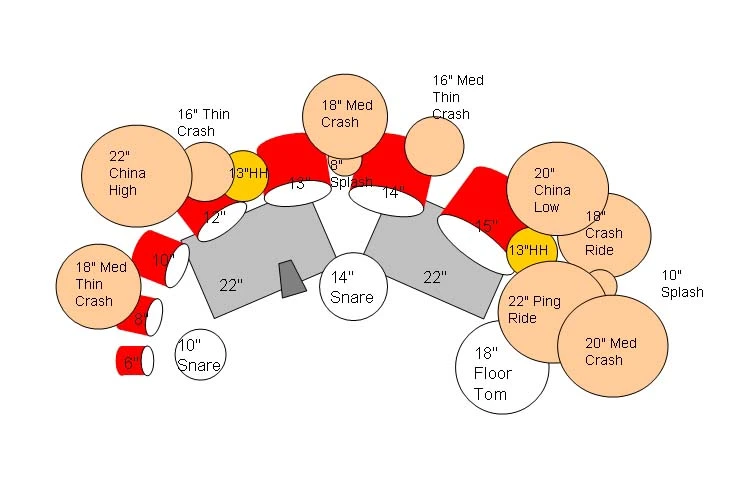

Our drummer plays a fairly large kit (as you can see at the bottom).
