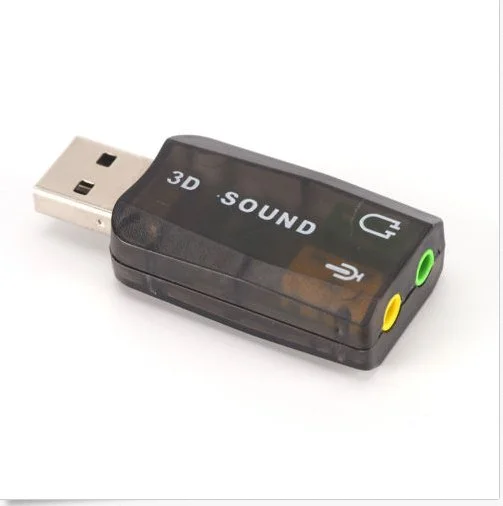

So, the USD soundcard is a cheap one that I bought in Kathmandu (where I live). It just says "3D sound" on it.

If your "sound card" looks like the one below I can pretty much say that is your problem. It is not much different than plugging into your computers MIC/LINE jack. The XLR to 3.5mm cable will not work unless it is specially wired to 'convert' the balanced out of the preamp to an unbalanced connection into PC or the USB thingy if it does work at.

That is indeed the USB "sound card" that I was able to find in the markets of Kathmandu.
