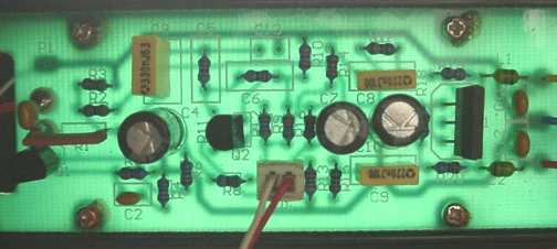

So from tracing the routing on the PC board, this 7 prong fellow looks like the transformer.
I requsted a schemait from Samson, but I'm not hopeful. Is there any kind of stardardization for these transformers, or is each manufacturer unique?
There can't be more than about $5 worth of components on this whole darn board, replacement should be fast and cheap, just what to replace...?
Should be a silver looking can near the base of the mic.
OK, then I don't think this little guy has it's own transformer. The everything it has is pictured... maybe it's $5 down the drain :(
No this guy is not a transformer, but dual monolithic BJT. Most likely 2SA1349, or similar. This is a transformerless design. Before you do anything, put the mic into a zipped bag with fresh silica pack and leave it overnight. Make sure that the pack is FRESH. Then we will see.

I'd think the most likely culprit would be the FET or one of the caps. You could probably replace the FET with a 2SK170 type which are cheap and easy to find.
Attached is another view of the board showing the traces, just for shits.
Actually, on a second thought to rule out the capsule try to unsolder its lead (the one, which goes to capacitor). Fire the thing up, keeping gain low. If there is hum only, then it is capsule, if the noise persists, then... something else....
