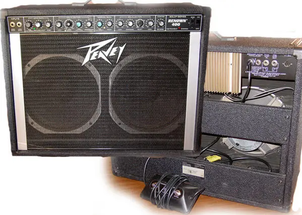

Ok, the amp I have is a Peavey Renown 400, and the back Preamp out/In jacks are 1 volt RMS with a low impedance of 600 ohms, which I have no idea how this translates over to -10, consumer, or +4 Db line level. Any idea on that?
Power amp input is going to want a standard line level signal. I wouldn't sweat that one bit.
